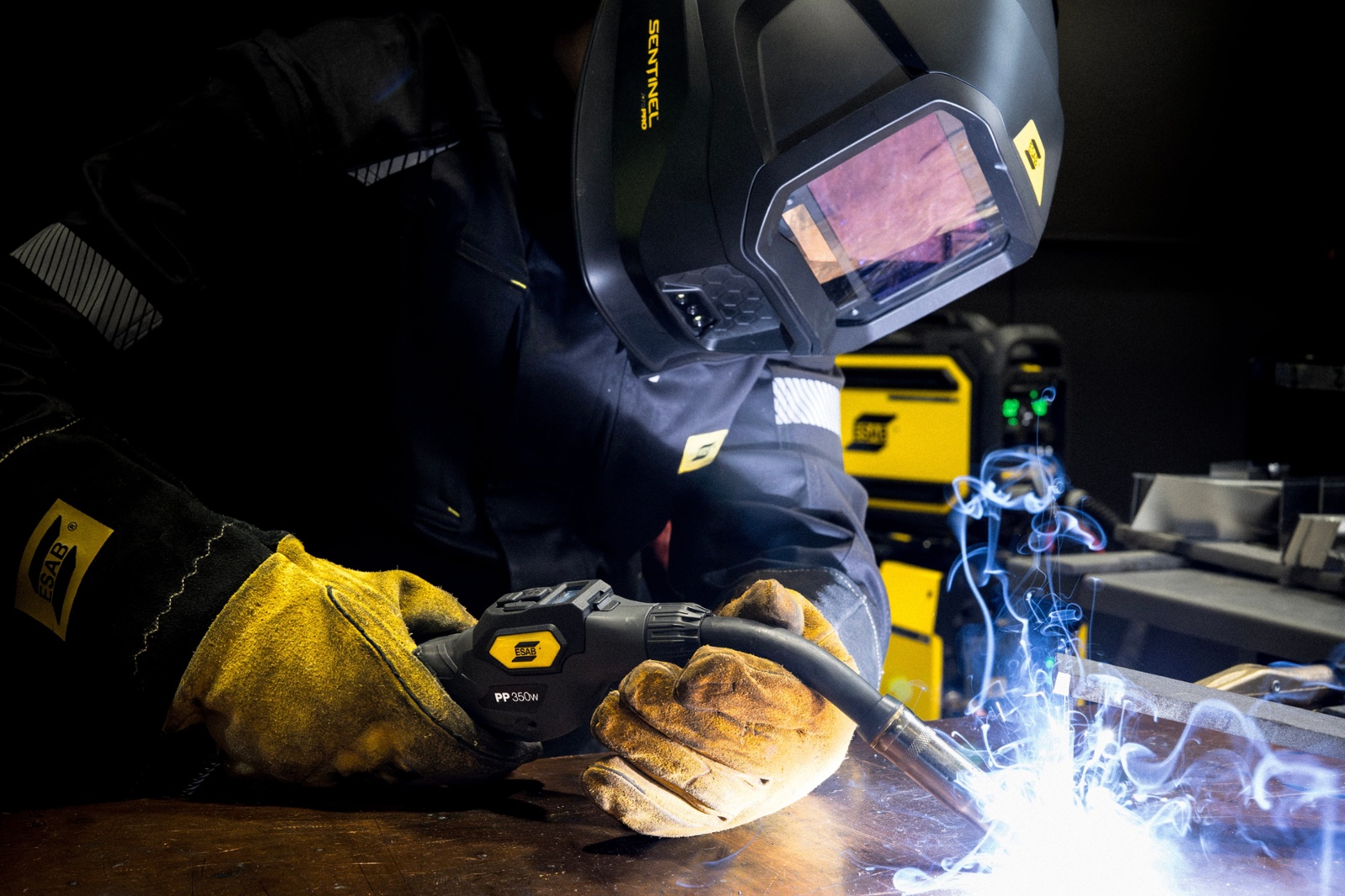

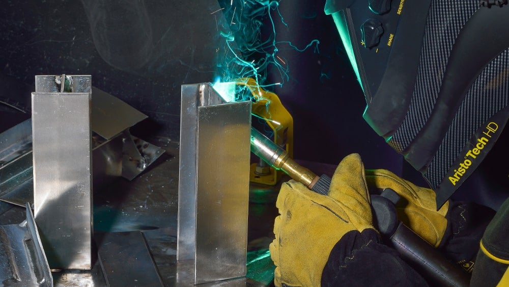

How to Weld Aluminium with a MIG Welder
Techniques & Considerations
  • Use a spool gun or push-pull system to prevent wire feeding problems — see our guide to Improving Feedability and Wire Delivery in Aluminium MIG Welding
  • A faster travel speed helps avoid burn-through and reduces the risk of overheating
  • Push the torch rather than pulling it — this improves gas coverage and reduces the risk of contamination
  • Spray transfer mode produces less spatter and a smoother arc on aluminium compared to short-circuit transfer
