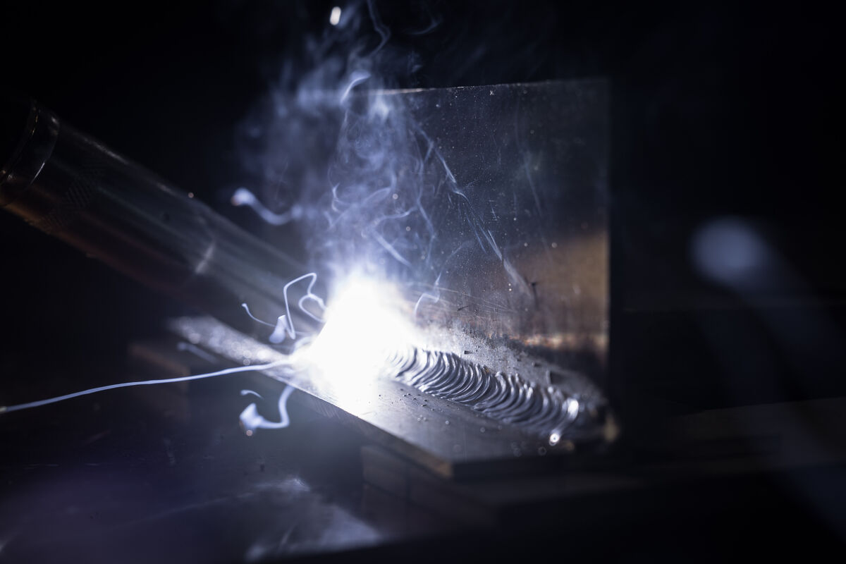

A well-configured machine setup is fundamental to successful aluminium GMAW (Gas Metal Arc Welding). Unlike steel wire, aluminium wire is softer and lacks column strength, making it considerably more susceptible to feeding problems such as bird-nesting and tangling. Correctly configuring every element of your wire feeding system helps prevent costly downtime and the frustrating feed issues that are sometimes accepted as inevitable when transitioning from steel to aluminium welding.
Why Aluminium GMAW Machine Setup Matters
Most GMAW machines are supplied configured for steel wire, which is stiffer and more forgiving to feed. Because aluminium wire is softer and more flexible, operators experienced with steel welding may not recognise the need to adjust their machine setup, leading to persistent wire feeding difficulties. Understanding each system component and how to optimise it is the most reliable way to reduce feedability problems and maintain arc stability.
