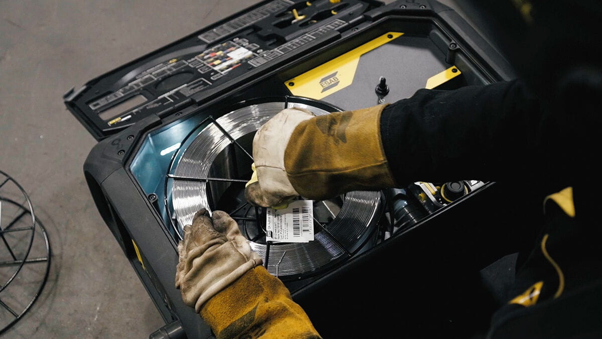

Spool — Starting at the spool end of the system, brake setting tension should be reduced to the minimum level needed to prevent the spool from free-wheeling when welding stops. Any brake pressure above this threshold increases the risk of feeding problems and burn-backs. Electronic braking systems, and combinations of electronic and mechanical braking, have been developed to provide greater sensitivity and are particularly beneficial for aluminium wire feeding.
