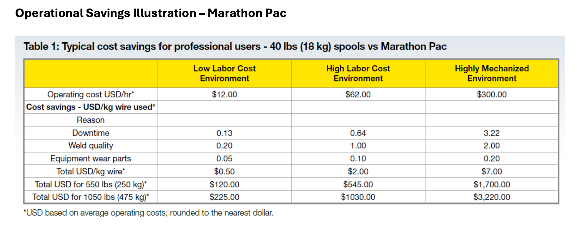

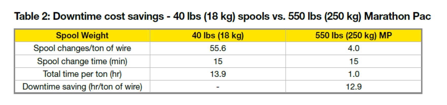

This is Part 2 of 3 in ESAB University’s filler metal packaging selection series. Part 1 established the selection framework and “which format fits which job.” This article focuses on bulk wire drums—how MarathonPac™ reduces non-welding minutes, where it fits best, and how to estimate productivity and cost impact in real production environments. Quick Links What MarathonPac is and where it fits Why bulk drums win (uptime + station cost) The savings model (hours per ton + $/kg examples) Estimate your savings (worksheet) Setup and integration checklist Learn more What MarathonPac™ Is (and Where It Fits) MarathonPac™ is ESAB’s octagonal, cardboard bulk wire drum system designed for GMAW welding wires. The drum is foldable after use, can be shipped on a pallet (saving storage space vs round drums), has no metal handles or rings, and uses recyclable components for standard separated waste disposal. It is available across a range of wire grades and drum sizes, covering steel, stainless steel, aluminum, and copper alloys, and is positioned for manual, fully automated, and robotic welding applications. Best-fit applications: high-volume GMAW production, robotic welding cells, and large-scale fabrication where spool changes create measurable downtime. Why Bulk Drums Win: Downtime Is Usually More Expensive Than the Drum Station cost is more than the welder’s hourly wage In the guide’s model, “operating cost” includes indirect labor (overtime/bonuses/social charges), depreciation of mechanized equipment, premises and auxiliary equipment, and overhead for supervision, QC, and support staff. That’s why station-cost assumptions range from low-labor to high-labor to mechanized environments. Changeover frequency is the lever Fewer wire changes reduce staging, loading, threading, and restart interruptions. In mechanized and robotic cells, minutes of downtime multiply in cost and throughput impact. Bulk packaging can also simplify logistics by reducing the number of packages handled per ton of deposited wire. The Savings Model Hours per Ton and $/kg Examples Worked example: hours saved per ton of wire The guide’s operational illustration compares standard 40 lb (18 kg) spools to a 550 lb (250 kg) MarathonPac with a 15-minute changeover time. It shows spool changes per ton dropping from 55.6 to 4.0, and total changeover time dropping from 13.9 hours to 1.0 hour—saving 12.9 hours per ton of wire. Download Brochure Illustrative savings by production environment The same model provides example total savings per kilogram versus 18 kg spools: $0.50/kg (low labor), $2.00/kg (high labor), and $7.00/kg (mechanized). It also provides example total savings per drum for 250 kg and 475 kg drum sizes. Takeaway: The more automated the cell and the higher the station cost, the greater the return from reducing changeover count and non-welding minutes. Estimate Your Savings in Your Own Cell Measure wire consumption: kg per shift/day/week per cell. Measure real changeover time: include staging, loading, threading, test feed, and restart. Calculate changeovers avoided: (wire used ÷ current spool size) − (wire used ÷ drum size). Convert to hours saved: avoided changes × minutes per change ÷ 60. Apply station cost: use a station-cost definition that includes labor + overhead + equipment time. Tip: track “wire changes per shift” and “downtime minutes per change” for 2–4 weeks before and after the conversion to quantify impact. Setup and Integration Checklist Bulk packaging succeeds when feeding and handling are disciplined. The MarathonPac setup video provides step-by-step guidance, including lifting/handling, dolly use, preparing the drum, preparing the hood, and connecting to the feeder. Implementation Checklist Material handling plan: define how drums are moved, staged, and secured (especially for larger sizes). Cell layout: ensure drum position supports smooth pay-off and avoids sharp bends in the wire path. Feeder readiness: confirm drive roll type and tension, guide condition, and liner condition for your wire type (solid vs cored, and softer alloys). Contamination control: keep the drum covered/closed when not in use to reduce debris risk in the wire path. Standardize changeovers: build a consistent process so every shift achieves the expected downtime reduction. Track KPIs: wire changes per shift, downtime minutes per change, arc-on time, and defect/rework trends (before/after). Next Up Part 3 will detail moisture-control packaging workflows and how to manage opened packaging without losing the benefit. Learn More on ESAB University MIG Welding Guide: Process, Parameters, and Best Practices MIG Wire Selection Guide Fine-Tuning Performance: Mastering MIG Welding Machine Settings Storing and Redrying Stick Electrodes the Right Way Baking Procedure for Welding Electrodes: Step-by-Step Guide
