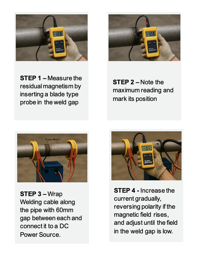

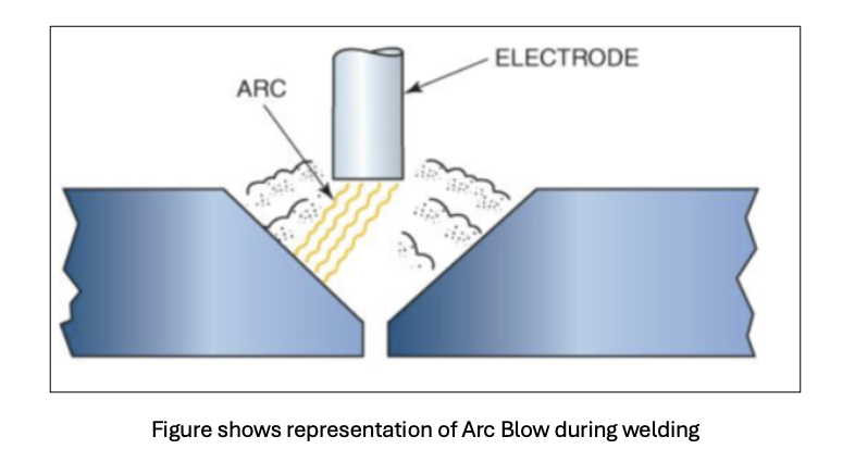

Magnetic arc blow (also called the electromagnetic blowing effect) is the deflection of an electric arc caused by magnetic fields created by welding current and/or residual magnetism in the workpiece. It is most common on ferromagnetic steels when welding with DC polarity, and it is often most disruptive at ends of joints, corners, and during root passes. Quick links Symptoms and weld quality risks What causes magnetic arc blow? How to measure residual magnetism (gauss and mT) Best fixes for arc blow (in the order to try) How to demagnetize a workpiece (field method) Magnetic arc blow FAQ Magnetic Arc Blow Symptoms and Weld Quality Risks A stable arc should track the joint line and respond predictably to small changes in torch/electrode position. With arc blow, the arc can be forced off-axis, making heat delivery and fusion less consistent—especially in narrow groove or root conditions. Arc “pulling” to one side of the bevel or fillet Unstable arc behavior and increased spatter (process dependent) Uneven bead profile (one toe washes out while the other piles up) Sidewall fusion inconsistencies and irregular penetration (especially at the root) Higher stop/start frequency, reduced travel speed, and increased rework From a quality standpoint, arc blow increases the risk of undercut, lack of fusion, and root discontinuities because the arc is no longer delivering heat where intended. What Causes Magnetic Arc Blow in Welding? DC Welding Current and Steady Magnetic Field Direction Arc blow is strongly associated with DC welding because the magnetic field produced by DC current has a fixed direction. If the field becomes asymmetrical (due to current path, geometry, or residual magnetism), the arc can be continuously deflected the same way. With AC, the current reverses direction each half-cycle, which often reduces the net deflection and improves arc centering (when the procedure permits AC). Read More: Metal Reactions to AC and DC Welding Explained Residual Magnetism in the Workpiece Residual magnetism is “magnetic memory” left in a component from handling or prior processing. Common sources include: Magnetic lifting and handling Forming, machining, or storage orientation Prior welding current paths Some inspection or processing steps that magnetize steel A critical detail is that magnetism that appears moderate on an outside surface can become concentrated at the root gap after fit-up (especially in pipe and narrow-groove joints). For troubleshooting, measure at the gap whenever possible. Return Clamp Placement, Current Path, and Cable Routing The work return (ground clamp) defines where current leaves the workpiece. That current path determines the magnetic field distribution around the joint. Arc blow typically worsens when the return is far from the weld, when current funnels through the weld end, or when cable routing/coiling creates localized fields near the joint. Geometry Effects: Ends, Corners, and Tack-Heavy Fit-Up Even with correct parameters, joint geometry can amplify arc blow. Ends of welds concentrate current and field lines, corners and restraint can create strong imbalances, and heavy tack-up or temporary attachments can disturb symmetry in current flow. How to Measure Residual Magnetism (Gauss and mT) Units and Quick Conversions Residual magnetic field is commonly measured as magnetic flux density in gauss (G) or millitesla (mT). 1 mT = 10 gauss 50 gauss = 5 mT Where and How to Measure For joints where arc blow is suspected—especially pipe roots—measure in the weld gap using a gaussmeter with a thin or blade probe. Scan around the joint and record the maximum reading and its location. The maximum often correlates to the zone where arc stability and fusion control are most at risk. Practical Threshold Guidance “Problem” levels vary by process, polarity, joint design, and arc length. In practice, treat tens of gauss in the root gap as a potential stability risk, and prioritize mitigation when arc blow is visible or readings are consistently elevated in the gap. Establish site-specific acceptance limits based on procedure qualification, production history, and NDT outcomes. Best Fixes for Arc Blow (In the Order to Try Them) 1. Optimize the Return Clamp Strategy Return placement is the fastest and lowest-cost control lever because it directly changes the current path and magnetic field distribution. Move the return clamp closer to the weld zone to shorten and simplify the return path. Reposition for more symmetric current flow relative to the joint. For long seams, relocate the return periodically to reduce field buildup in one direction. Where practical, use two return points to reduce magnetic imbalance. Technical note: Clamp contact area and cleanliness matter. High resistance at the return can destabilize the arc independently of magnetism. Use appropriately rated clamps for the current and duty cycle, and ensure jaw contact is secure on clean metal. Read More: Stick Welding Guide (SMAW/MMA): Process, Electrodes and Best Practices 2. Reduce Arc Length and Stabilize Technique A longer arc is easier to deflect. Tight arc length control improves directional stability and reduces the arc’s tendency to wander in a non-uniform magnetic field. SMAW (Stick/MMA) Run the shortest stable arc length practical for the electrode and position. Avoid excessive amperage that increases arc force and instability at the root. Maintain consistent electrode angle; small changes can exaggerate drift in high-field zones. GMAW (MIG/MAG) In CV modes, arc length is strongly influenced by voltage; avoid unnecessarily long arcs. Control CTWD/stickout tightly to reduce current and arc-length variability. Keep torch angles consistent; extreme push/pull angles can worsen tracking at the toes. GTAW (TIG) Maintain tight, consistent arc length; TIG arcs can drift quickly when length increases. Minimize lateral wandering; small deviations can compound magnetic deflection. Read More: MIG Welding Guide: Process, Parameters, and Best Practices 3. Adjust Welding Direction and Sequencing Arc blow often spikes near weld ends. If the joint allows, adjust sequencing to reduce magnetic imbalance at critical locations. Weld toward the return clamp rather than away from it (when practical). Use back-step or skip welding to avoid localized field buildup. Add run-on/run-off tabs so end effects don’t occur in the final weld zone. 4) Use AC (or AC for the Root) When the Procedure Allows If permitted by the WPS and process requirements, AC can reduce arc blow because the magnetic field reverses direction each half-cycle. A common strategy in difficult root conditions is AC for the root followed by DC for fill/cap—only where qualified and allowed by procedure controls. Read More: Polarity in Stick Welding: The Basics for Beginners How to De-magnetize a Workpiece (Technical Field Method) When arc blow remains directional regardless of return placement and technique, residual magnetism is often the root cause. In that case, de-magnetizing (degaussing) is the most direct corrective action. The procedure is shown below: Step-by-Step: Cable-Wrap Coil Compensation for Pipe Roots Measure flux density in the root gap with a blade probe and identify the peak location. Mark the peak point around the circumference. Wrap welding cable around the pipe near the joint to form a temporary coil (keep spacing consistent). Apply controlled current through the wrap while monitoring gauss/mT at the gap. If readings increase, reverse polarity or wrap direction and re-adjust. Once reduced to a workable level, complete the root pass. After the root is in, arc blow sensitivity often decreases. Safety note: This method can involve high current and strong magnetic fields. Use qualified personnel, secure cable routing, control heat exposure, and follow site safety rules (including precautions for implanted medical devices and magnet-sensitive equipment). Magnetic Arc Blow FAQ Filler Metal Selection Guide - Part 1 Filler Metal Selection Guide - Part 2 Filler Metal Selection Guide - Part 3 Storing and Redrying Stick Electrodes the Right Way Baking Procedure for Welding Electrodes: Step-by-Step Guide What’s the fastest way to reduce arc blow? Start with the return clamp: move it closer, change its position for symmetry, and improve contact quality. Then tighten arc length and adjust welding direction/sequencing. Why is arc blow worse at the end of a weld? Ends and corners concentrate current paths and create magnetic imbalance, which can push the arc off-center. Run-on/off tabs and sequencing changes can reduce end effects. Is arc blow a parameter problem or a setup problem? Usually a setup/current-path problem first (return placement, geometry, residual magnetism). Parameter changes help most when they shorten arc length and stabilize the arc rather than trying to overpower magnetic imbalance. Learn More on ESAB University
