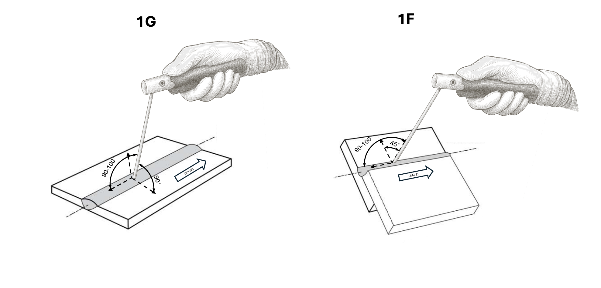

Flat Position (1G/1F)
Flat welding provides the most forgiving environment for developing angular control fundamentals. Maintain the work angle at 90 degrees perpendicular to the plate surface, though slight adjustments to 85 degrees may improve visibility without compromising results. The travel angle should remain between 5-10 degrees drag to promote proper slag flow while maintaining adequate penetration.

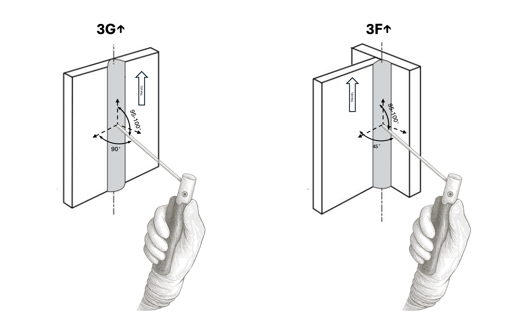

Vertical Position (3G/3F)
Vertical welding fundamentally changes electrode positioning requirements. For vertical-up progression, shift to a push technique with the electrode tilted 5-10 degrees toward the direction of travel. This pushing action supports the weld pool against gravity while maintaining penetration and as well assuring proper bead appearance and reinforcement. Gravity plays an important part here while liquid slag solidifying itself and weld pool, so less than 5 degrees will change arc behavior, leading to defects. Reduce amperage approximately 10% compared to flat position settings to prevent excessive fluidity.

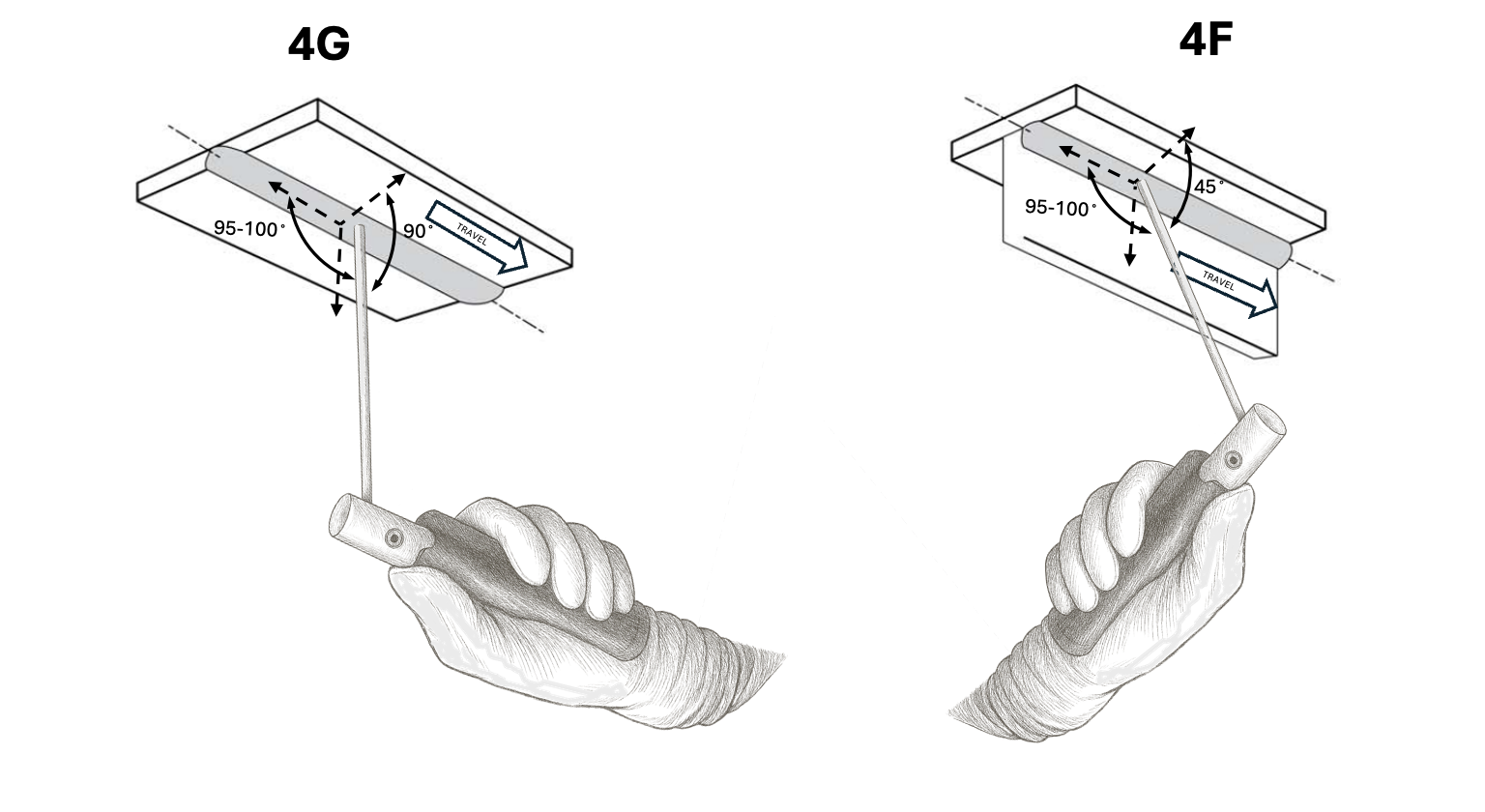

Overhead Position (4G/4F)
Overhead welding demands the most restrictive angular parameters. Work angles approach 90 degrees
perpendicular to maintain heat distribution while travel angles remain minimal at 0-10 degrees drag. The complete opposition of gravitational forces requires shorter arc lengths and careful angular consistency to prevent molten metal displacement.
