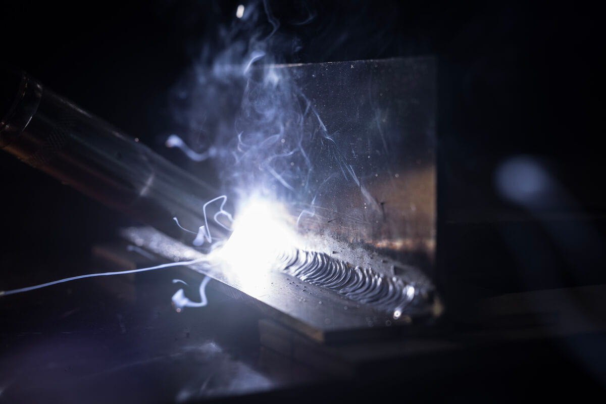

Can you weld aluminium with direct current? Whilst alternating current is the standard choice for aluminium welding, and direct current carries its own limitations when working with this sensitive material, DC welding is possible. Before selecting between AC and DC, however, it is essential to understand the specific challenges that aluminium presents — and how each current type addresses them.
Aluminium has a distinctive set of properties. It is soft, ductile, and lightweight, yet also highly corrosion resistant — characteristics that make it a material of choice across oil and gas, marine, construction, and general fabrication. Without the right welding approach, however, problems such as arc blow, burn-through, and incomplete fusion can compromise the weld. Below we examine how alternating and direct current each affect weld outcomes when working with aluminium.
Alternating current is the preferred choice for aluminium welding, primarily because of aluminium's high susceptibility to oxidation. Exposure to atmospheric oxygen rapidly forms an aluminium oxide layer on the surface, which creates difficulties when initiating and maintaining an arc. Breaking through this oxide layer typically requires significant heat input — yet excessive heat risks burning through the relatively soft aluminium base material.
The key advantage of AC for aluminium welding is its continuous polarity reversal. As the direction of electron flow alternates, it produces a cleaning action on the oxide layer — often described as a sandblasting effect — that progressively breaks it down. The resulting weld is clean and free of oxide contamination. That said, AC welding on aluminium does present its own challenges:
Through careful parameter control and the use of advanced AC technology — such as square wave inverters with adjustable balance and frequency — AC welding can be made significantly more effective and economical across a wide range of aluminium applications.
Where AC welding has limitations, DC can offer advantages. Direct current produces a stable, consistent arc due to the unidirectional flow of current, which generates sufficient heat to weld aluminium sections greater than approximately 6 mm in thickness. When TIG welding with DC, electrode negative (DCEN) is preferred for deeper penetration, whilst electrode positive (DCEP) provides oxide cleaning action at the surface.
Whilst DC welding is the better fit in certain applications, its limitations must be understood before committing to it:
Despite these constraints, good weld results are achievable with direct current on aluminium when the correct procedure, parameters, and preparation are in place.
Sound fusion, freedom from defects, adequate strength, and weld purity are the benchmarks of a quality weld regardless of material. With aluminium, achieving these outcomes requires careful management of heat input — enough to achieve fusion and break down the oxide layer, but not so much as to cause distortion or burn-through. As a general guide, AC welding is the preferred option for thin aluminium sections welded in a single pass, whilst DC welding offers advantages on thicker material where greater penetration depth is required.
Regardless of current selection, a thorough understanding of the workpiece and application is essential. The right combination of electrode type, welding technique, welding equipment, shielding gas, pre-weld cleaning procedure, and material thickness will determine whether the finished weld meets the required quality standard.
