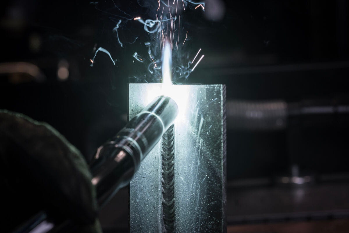

A weld is only as good as the joint preparation behind it. This introductory guide covers the essentials of weld surface preparation, joint design, and pre-weld practice — the foundations of consistent, high-quality results.
Before beginning any welding project, keep the 5P rule in mind: Proper preparation prevents poor performance. You can produce the neatest weld bead in the world, but without removing potential contaminants beforehand, the integrity of that weld cannot be guaranteed.
