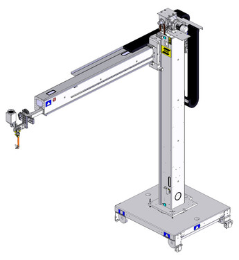

ProductivityIn today´s industrial development, the rate of productivity has been brought more and more into focus as a decisive parameter for raised profitability. This requires individually adapted production solutions, flexible enough to conveniently switch over, without extensive rebuilding, between a variety of applications. In close co-operation with the welding industry ESAB has created an application oriented Column and boom range with integrated modular functions in order to meet our customers´ demands for purposeful solutions on a competitive market. Stability and reliability CaB 460M has a stable and robust design of the profiles and saddle providing large working ranges and heavy load capacity with ample safety margins for reliable operations. Different types of foundations are available; rail carriage, concrete stand or steel plate – to fit any need. The lift drive has a reliable safety factor and is supplied with a security device which, regardless of boom position, immediately locks the boom to prevent unwanted descent in the event of a breakdown. Positioning of the horizontal boom can easily be carried out both in the vertical and horizontal direction. An even and stable welding speed is secured by the rack and pinion drive. The control system has been designed with totally integrated functions; welding head manipulation and operation of the column and boom – of course remote controlled.Individual solutions When dressing up the naked column and boom into a complete welding solution, the optional combinations are almost unlimited. In order to facilitate the selection process to result in a specification based on customer´s application, there is a computer aided configuration system available. Together with the ESAB representative the customer is able to build up his welding solution, i.e. a specification of the modular components to be assembled and installed at the customer´s workshop in a most convenient manner. For all modular components applicable for this column and boom, kindly refer to our range of leaflets available from our representative.
