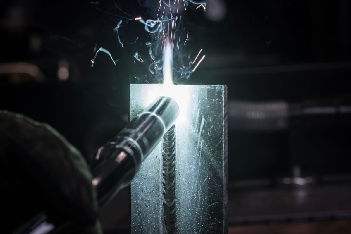

A skilled welder performing aluminum welding with a bright arc in a fabrication shop.
Stable, defect-free aluminium welding is much easier when the whole system is designed for aluminium – not just swapped liners and a different gas.
