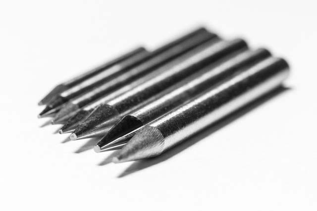

Tungsten inert gas (TIG) welding, otherwise known as gas tungsten arc welding (GTAW), is known for producing a clean and precise weld, and tungsten electrodes play a central role in it. From providing excellent thermal conductivity to ensuring precision arc control, using tungsten electrodes adds to the various benefits of TIG welding. Thus, it is important that the TIG tungsten size be selected carefully to add to the quality of the weld.
This article will discuss the different selection criteria for TIG tungsten electrodes.
There are many factors that affect the choice of the right tungsten size when TIG welding - the weld amperages, material thickness, and tungsten type, to name a few.
The table below is the recommended TIG tungsten size for welding material of a wide range of thicknesses.
