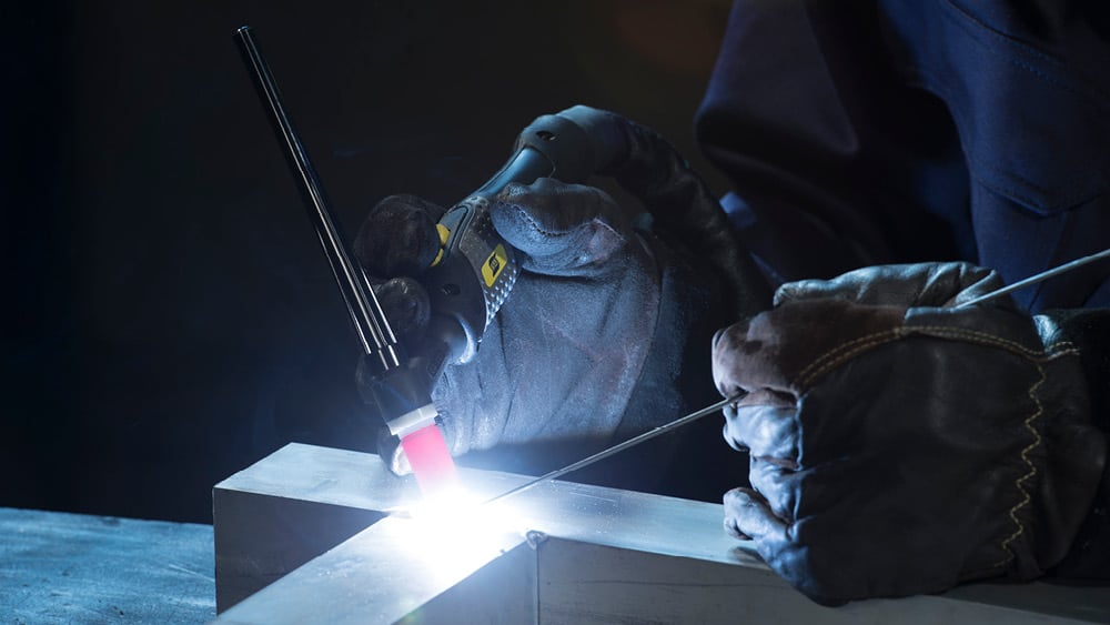

TIG welding, short for “Tungsten Inert Gas Welding”, is a process known for creating precise, clean welds on various materials. It's especially useful for critical welding jobs in aerospace, food equipment, high-purity processing, and motorsports.
In this beginner's guide, we'll cover:
TIG welding uses a special torch with a tungsten electrode to heat the metal that is being welded. This process is protected by a shielding gas, typically argon, to keep out impurities, this is also fed from the torch. The power source generates an arc from the tungsten electrode to the workpiece which creates a molten metal pool. The reason that the electrode is made from tungsten is so that it does not get consumed, and filler metal is added into the molten pool separately. The key to good TIG welding is carefully manipulating the weld pool and consistently feeding the filler wire.
