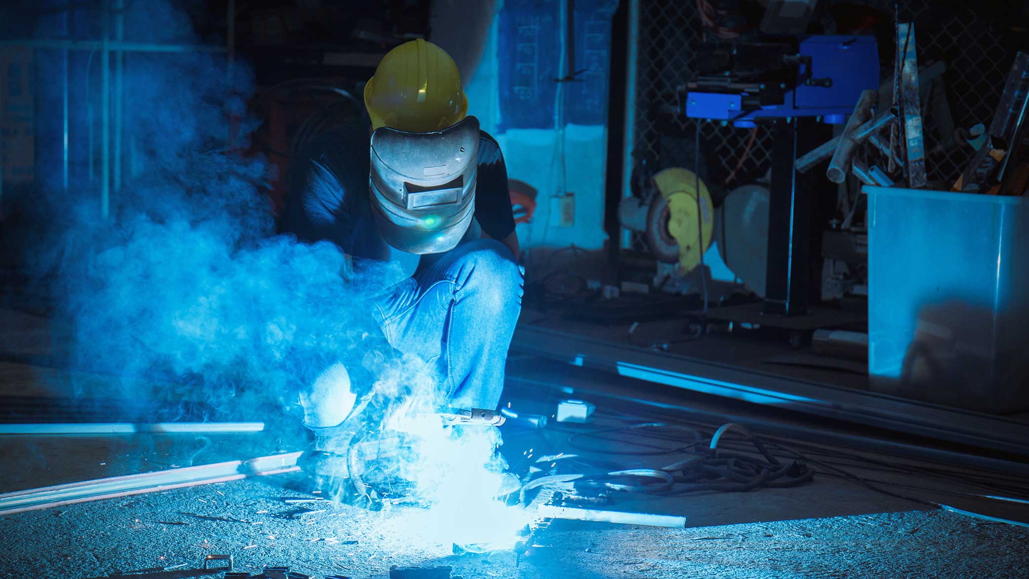

Welding is at the heart of modern manufacturing, fabrication, construction, and maintenance. While it is an essential industrial process, it also generates welding fumes that can pose serious health risks if not properly controlled. Creating a safe welding environment is not only about protecting the welder at the arc, but also safeguarding co-workers, visitors, and others working nearby.
Welding fumes are a complex mixture of very fine metal particles and gases produced when metals are heated above their boiling point and then condense into airborne particles. The composition of these fumes varies depending on the welding process, base material, filler metal, coatings, and shielding gases used. Common substances found in welding fumes include iron, manganese, chromium, nickel, zinc, and various gases such as ozone and carbon monoxide. Because these particles are extremely small, they can easily be inhaled deep into the lungs, making exposure a significant occupational health concern.

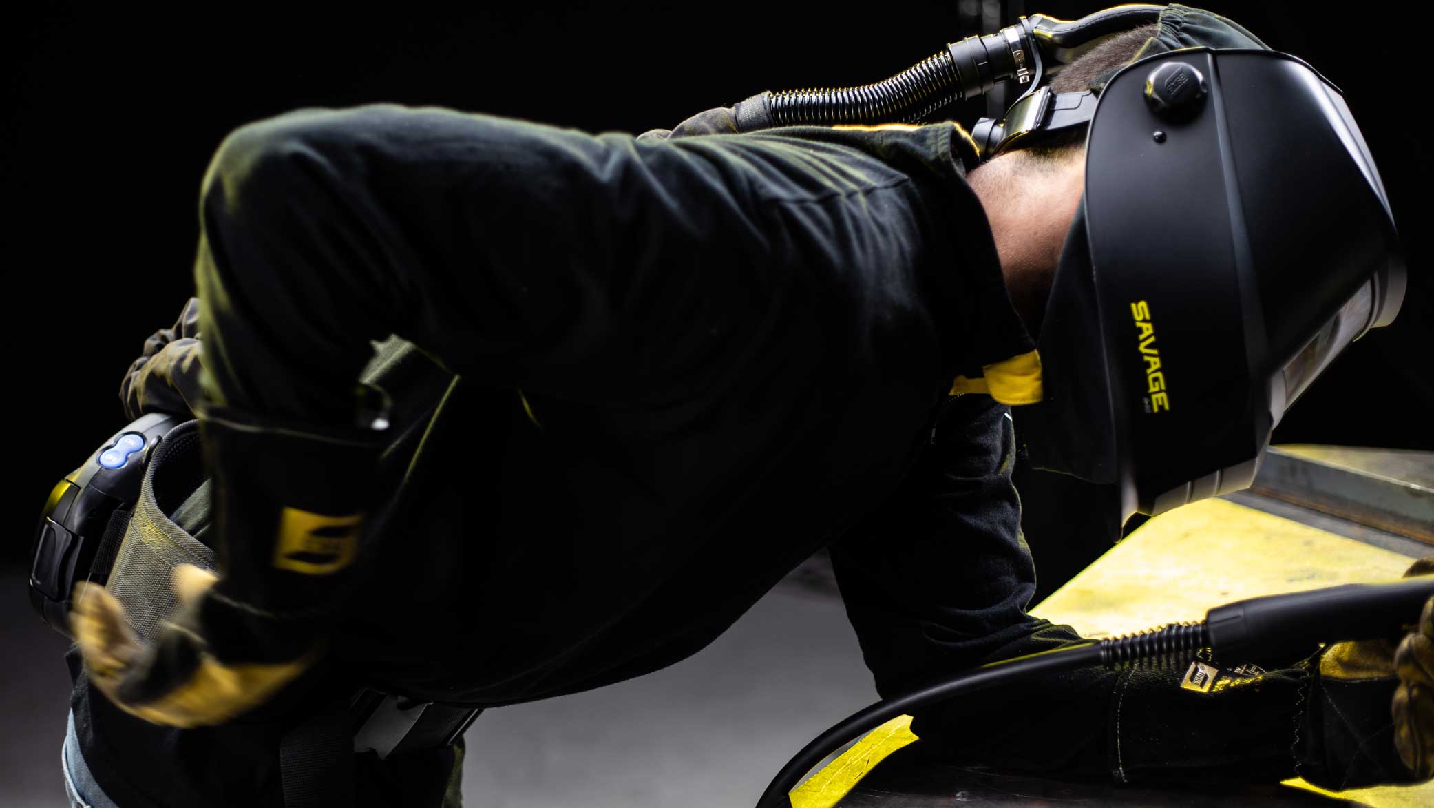

A powered fresh air welding helmet is the first line of defence for a welder, who has maximum exposure to welding fumes. Suitable fire retardant nose masks will also help partially, to keep a welder safe.

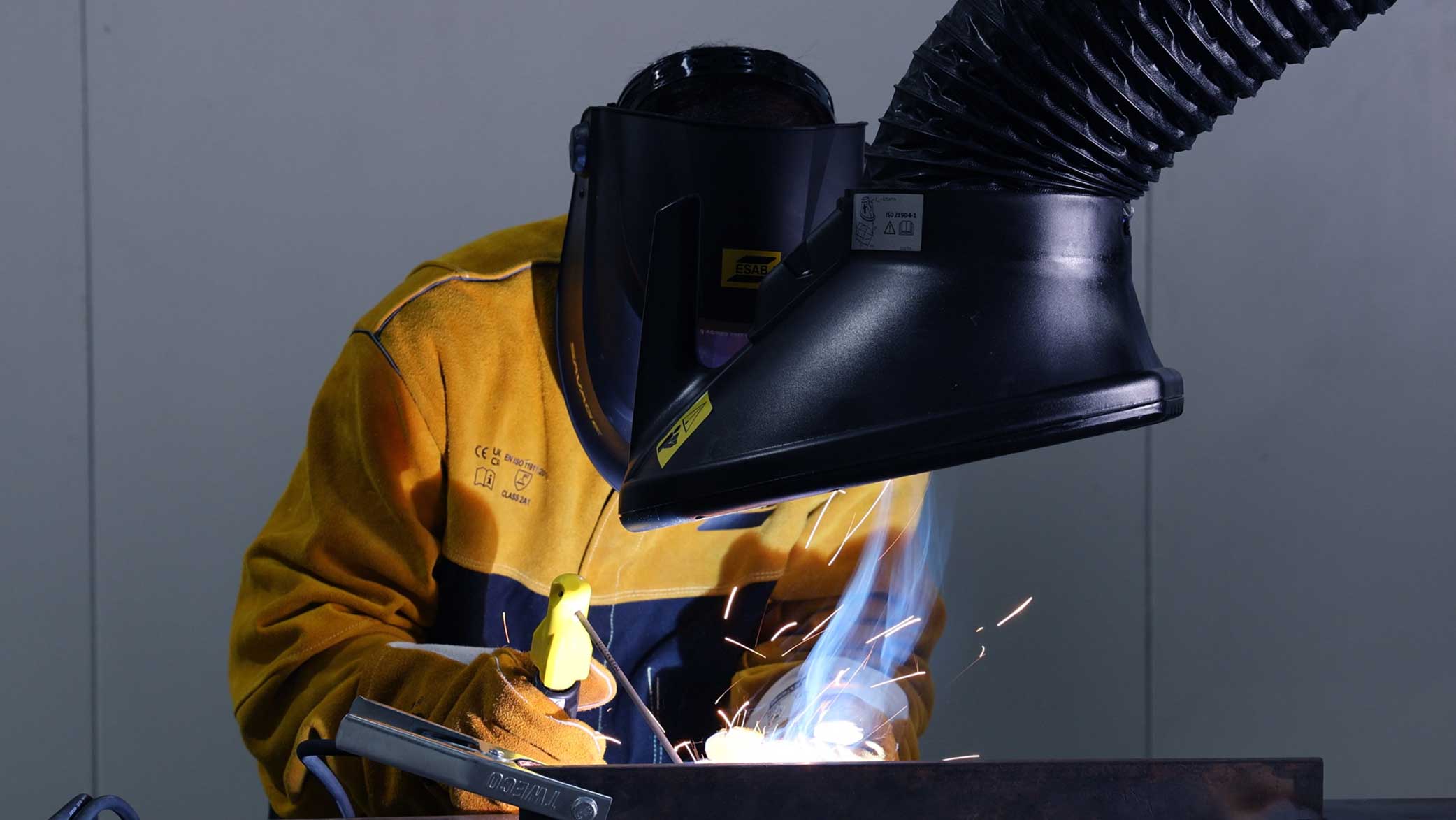

Local Exhaust Ventilation (LEV) systems capture fumes directly at the source before they reach the welder's breathing zone. General or mechanical ventilation can help dilute airborne contaminants within the workspace.
Local exhaust ventilation can be centralised or localised. Whenever possible:
