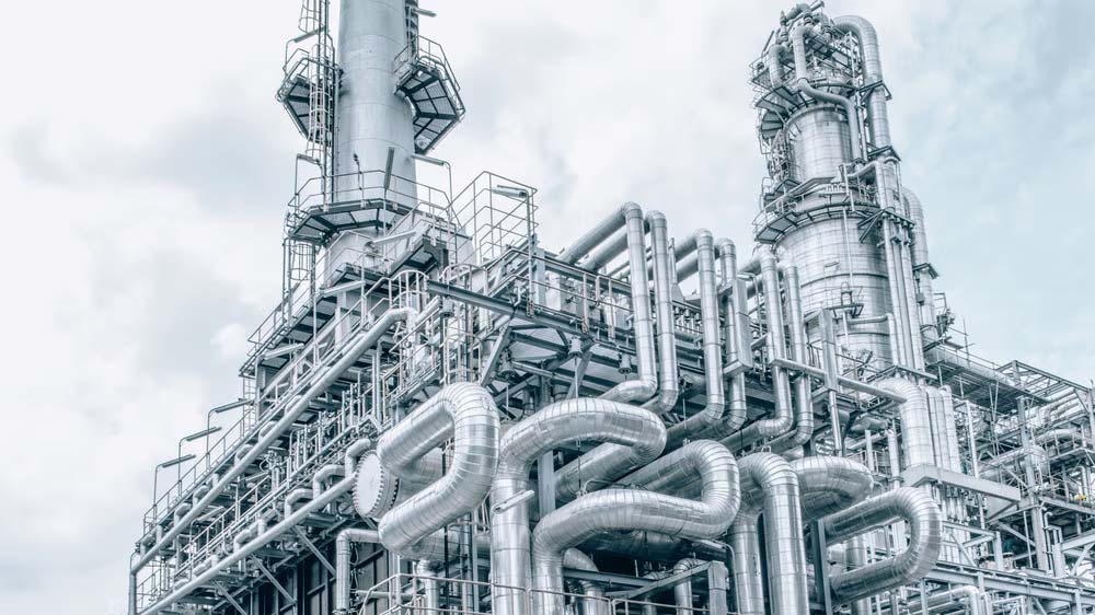

The assembly of piping systems, both within and external to oil refineries, depends on the quality of petroleum pipe welding implemented. This is due to safety concerns for workers and others near the site, and for the purity of the contents. Hazardous conditions within a refinery may include extreme temperatures, unpleasant odors, and the potential for explosions that may create hydrocarbon vapor clouds and threaten nearby populations. To ensure that a rupture event does not occur requires knowledge of the petroleum pipe welding challenges and the best techniques and equipment to mitigate their occurrence.

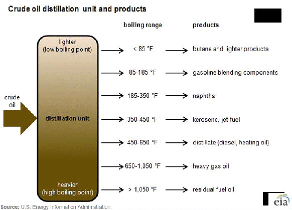

The processes for acquiring the raw materials needed to deliver the petroleum products we rely on for everyday needs can be dangerous. This is especially true when acquiring oil and gas for use as energy, which begins with terrestrial or aquatic drilling, and is followed by thermal processing or refining into fractions—shown in the figure below—and then delivery.
As shown above, the refining of crude oil or distillation into usable petroleum products or fractions involves high temperatures and pressure vessel welding. Additionally, much of the infrastructure for this process is piping, including iron, copper, and plastic (PVC and PE). However, stainless steel may be the most prevalent, and it does come with welding challenges.
