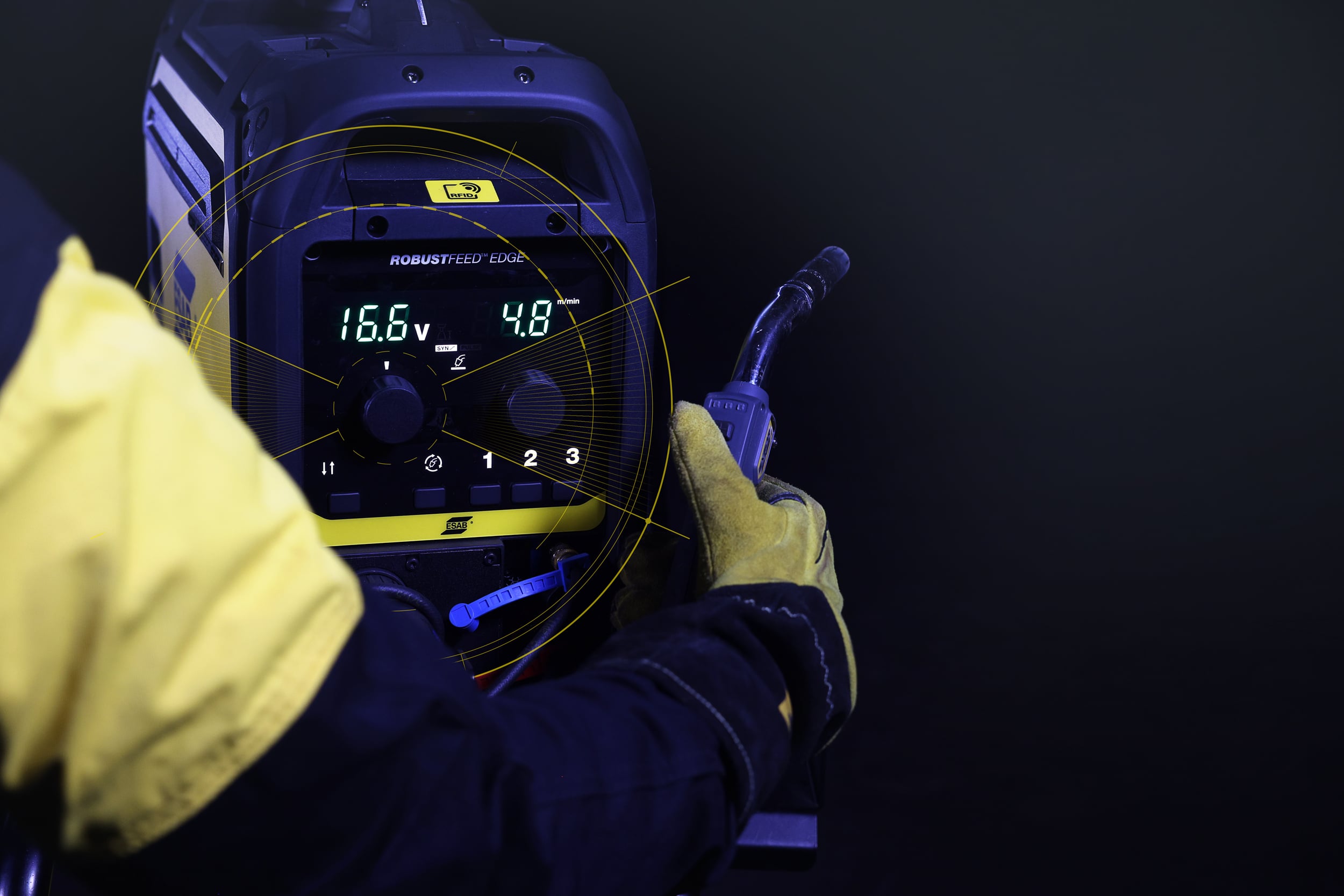

Welder holding an ESAB RobustFeed Edge machine in a dark room with panel on.

RobustFeed Edge — for Warrior Edge power sources
The RobustFeed Edge is ESAB's latest-generation heavy industrial wire feeder, designed to work with the Warrior Edge power source and deliver the full capability of the Edge's advanced WeldModes. Key features:
  • TrueFlow digital gas control — manages shielding gas precisely at arc starts and during welding, reducing gas wastage and improving start quality
  • PreciDrive wire drive system — precision feeding for consistent weld quality across all wire types including aluminium and soft wires
  • Integrated heater to prevent moisture condensation in cold and offshore environments
  • WeldCloud connectivity for real-time data monitoring and parameter management
  • Push-pull capable for aluminium and long cable run applications
  • Available in air-cooled and water-cooled configurations
