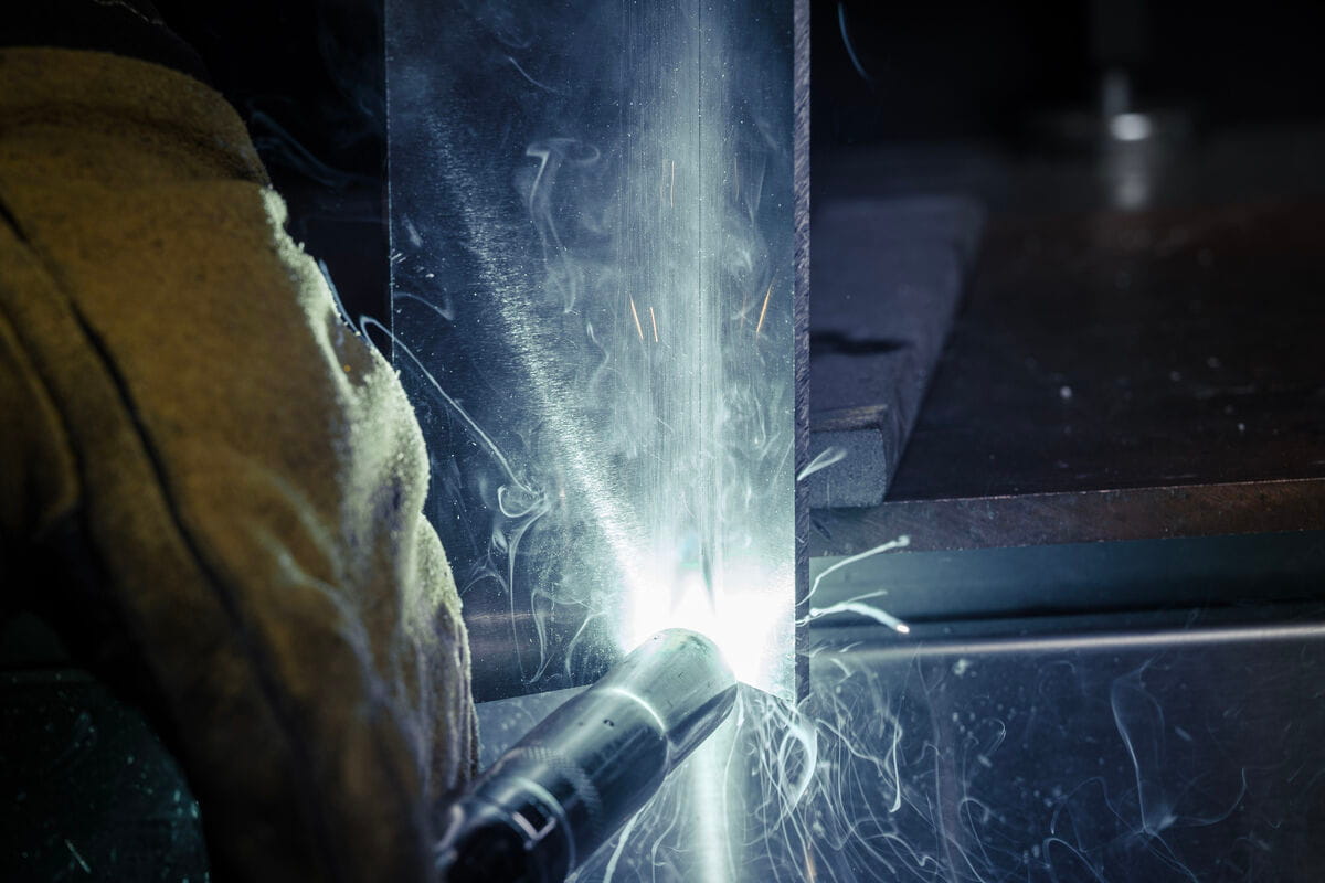

Aluminium Welding Process
Step 1: Preparing the Aluminium
  • Remove the oxide layer to create a clean surface - you can use tools like a stainless steel wire brush for this. You should make sure to brush in a single direction, so that the oxide is properly removed instead of mixing into the aluminium.
  • Degreasing with an aluminium cleaner or acetone will help remove any contaminants from the aluminium before you start.
  • If the aluminium is thicker, you should make sure to preheat your welder to 200 degrees fahrenheit (65-95 degrees celsius), to reduce the chance of your weld cracking. It will also help improve weld penetration, leading to a cleaner weld.
  • Select your shielding gas - for thicker aluminium, a mix of argon and helium is often used to increase the heat input. Otherwise, 100% Argon is the most common option.
  • Choose your filler wire/rod - it's important to match your filler to the aluminium alloy you're welding. For guidance on making the right choice, see our guide to choosing the right filler metal for aluminium welding.
Step 2: Welding Techniques & Solutions to Common Issues
The techniques and considerations involved in the process of welding aluminium will depend upon your chosen tools. That being said, there are a number of best practices and things to avoid, such as:
  • Making sure to use the correct heat settings to help avoid excessive warping
  • Using clamps or other stabilising measures to keep your piece in place, helping to reduce the chance of warping and imperfections.
  • Welding in the opposite (reverse or backstep) direction can help you distribute heat more evenly throughout your piece
  • Incorrect filler choice or rapid cooling can lead to cracking in the piece. This can be avoided with gradual cooling, and selecting the correct filler rod.
  • Contaminants or an improper gas flow can cause tiny holes to appear in your piece (porosity). Make sure to have proper gas shielding, clean the material thoroughly, and avoid drafts that could spread contaminants around the piece.
  • Having too low of a heat or lower travel speed can lead to burn-through or overheating. You should opt for a lower amperage, a faster travel speed or pulsing to combat this.
