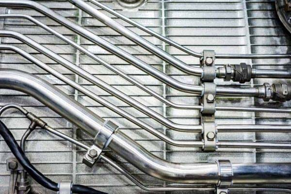

These advantages of autogenous welding make it ideal for jobs or projects in which thin-walled pipe or tubing is used, such as fuel and hydraulic lines for automobiles, industrial equipment, and aircraft, as well as piping for wastewater treatment and semiconductor processing. The use of this method should be limited to cases where pipe or tube wall thickness is minimal (approximately less than 3 millimeters); otherwise, lack of penetration depth may result in welds that are subject to failure. For precision and to optimize uniformity, an orbital welding process using an automated weld head is the best option. In addition to improved weld quality, orbital welding also increases the speed of production, which further increases the cost savings of not using a filler material.
