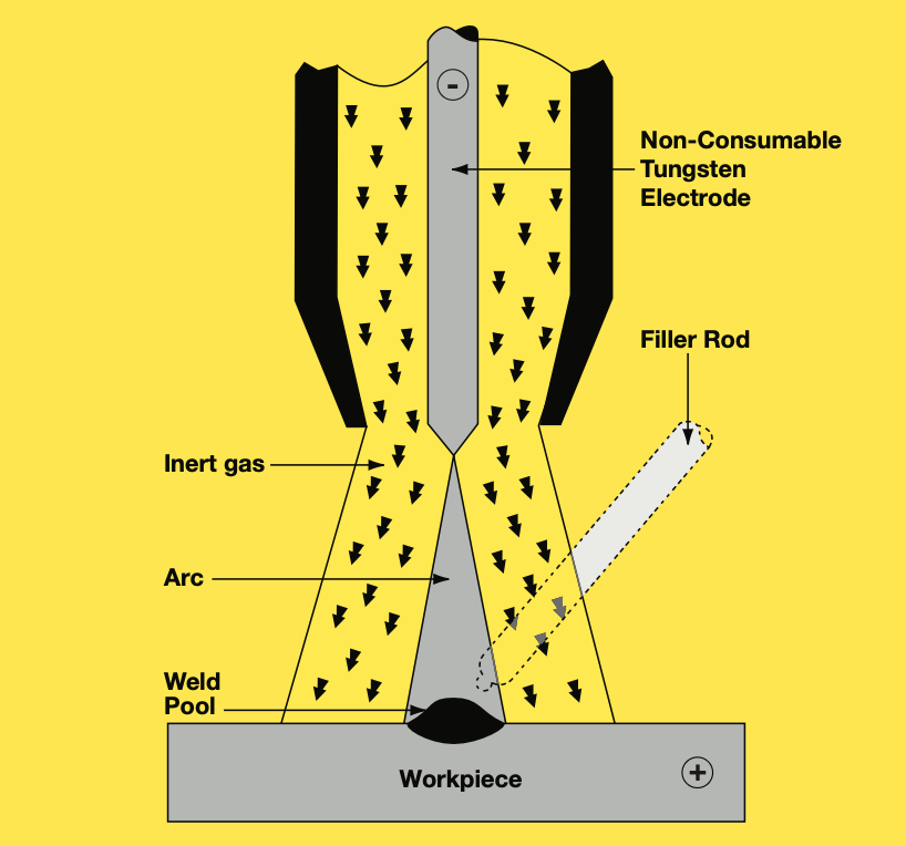

Tungsten Inert Gas (TIG) welding — formally Gas Tungsten Arc Welding (GTAW) — is the most precise arc welding process. It uses a non-consumable tungsten electrode to create the arc, with optional filler rod addition, and relies on an inert shielding gas (typically high-purity argon) to protect the arc and weld pool from atmospheric contamination. The absence of flux and the clean shielding environment mean no slag, minimal spatter, and excellent metallurgical integrity.

The TIG arc is established between a sharpened tungsten tip and the workpiece. Tungsten’s melting point (~3,422 °C) ensures the electrode does not melt into the pool; the arc supplies heat to fuse the base metal. Autogenous welds fuse joint edges without filler and are common on thin stainless or titanium. Where reinforcement, gap filling, or tailored properties are needed, a matching filler rod is added manually to the pool’s leading edge, always inside the gas envelope.
Arc length is typically controlled within 1–3 mm; excessive length causes arc wandering, oxidation, and porosity. Torch angle of ~10–15° in the travel direction improves visibility and gas coverage. Dipping the tungsten into the pool or touching the filler to the electrode contaminates the tip, destabilising the arc and risking tungsten inclusions.

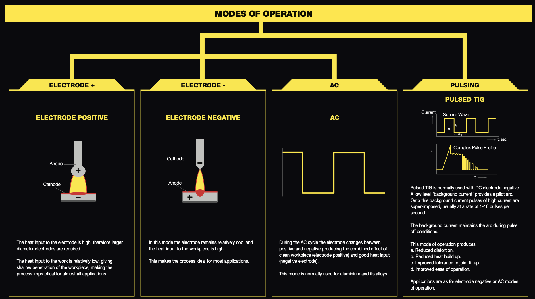

TIG requires a constant-current (CC) power source with a drooping volt–ampere characteristic: current remains stable despite small changes in arc length. Most sets provide DC, AC, or AC/DC. DC electrode negative (DCEN) concentrates ~70% of heat into the workpiece; AC alternates polarity to clean oxide films and penetrate, essential for aluminium and magnesium.

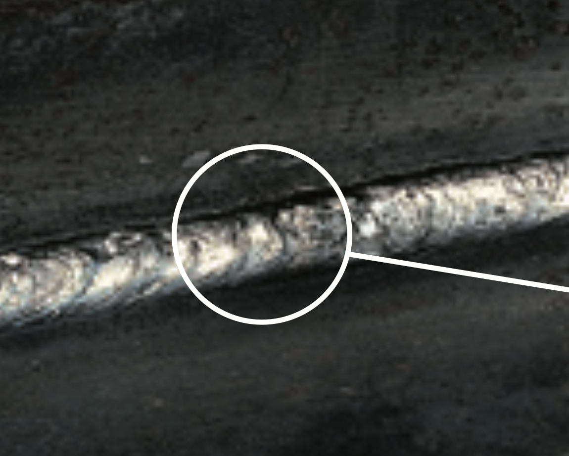

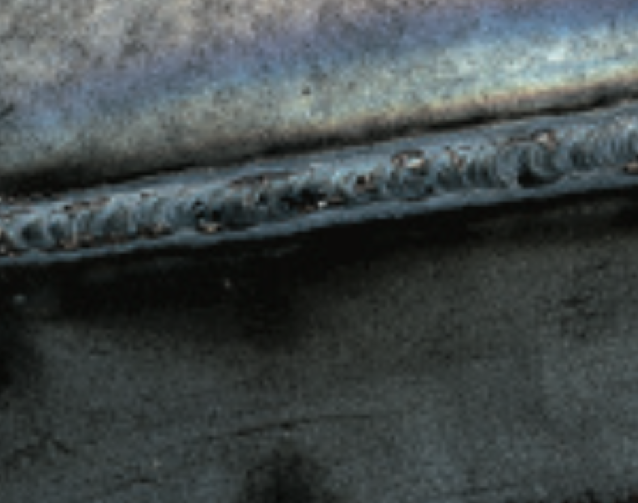

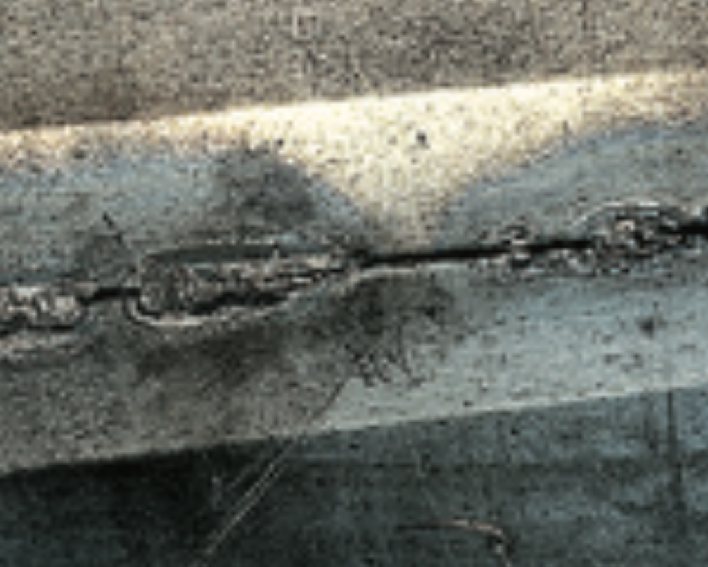

Typical discontinuities and how to address them:

Use pulsed TIG on thin stainless, titanium, or heat-sensitive joints to reduce overall heat input and stabilise a small weld pool. It improves out-of-position control and helps manage distortion.
Colouring indicates oxidation due to inadequate shielding or too short a post-flow. Increase post-flow, ensure the cup is correctly sized, reduce arc length, and shield the rear of the joint when required (e.g., purge for stainless pipe).
