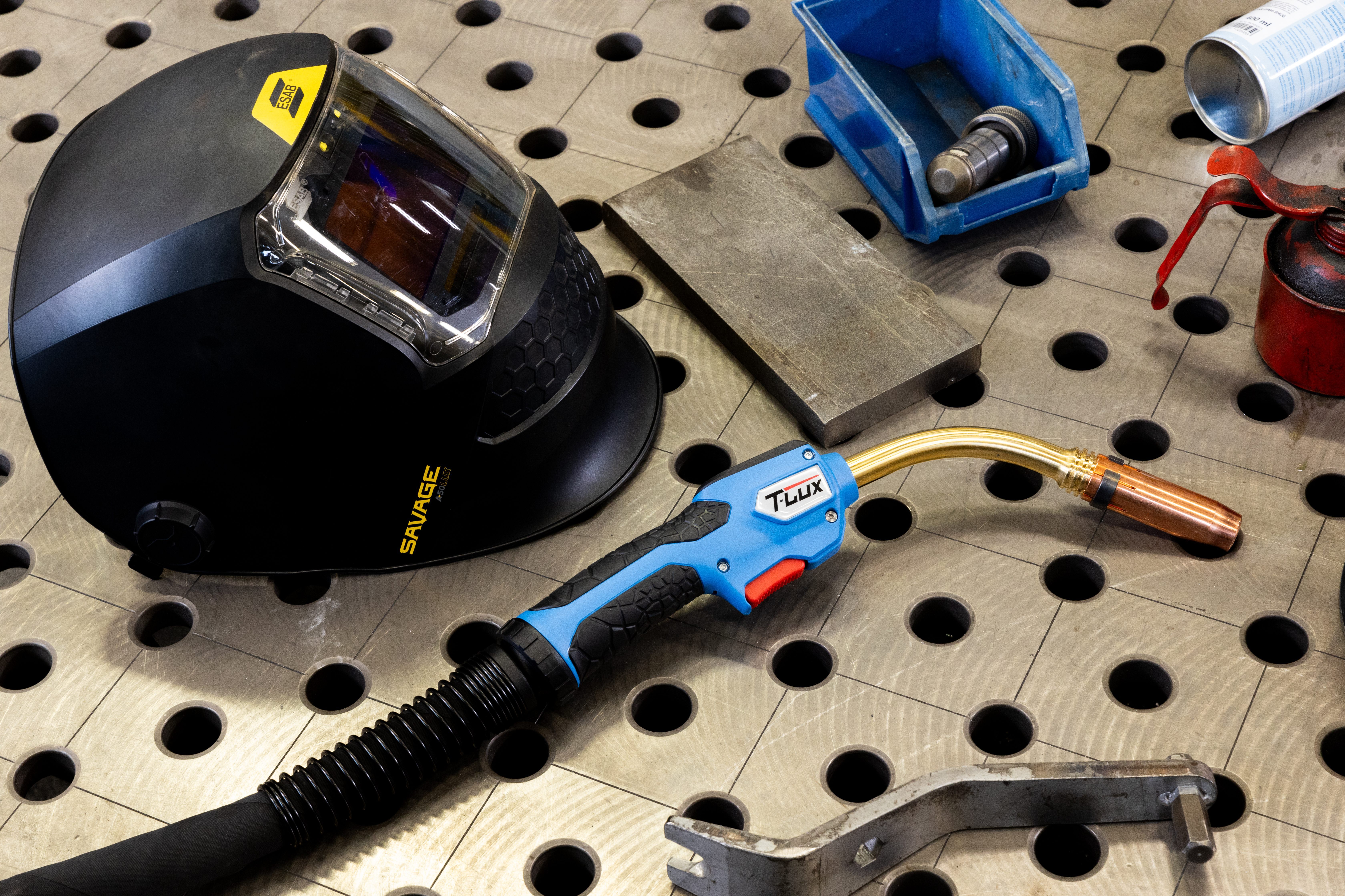

TBi mig torch with ESAB helmet and other accessories on a metal welding table.
