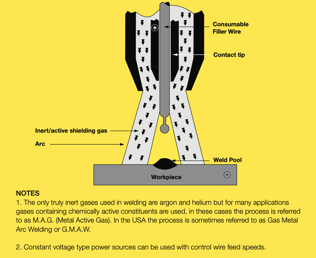

MIG welding relies on an electric arc established between the end of a consumable filler wire electrode and the workpiece. The heat generated by the arc melts both the wire and the surface of the base material, creating a molten pool. As the wire is continuously fed, it provides both filler material and the current path for sustaining the arc.
The arc and pool are protected from atmospheric contamination by a shielding gas, supplied externally. This prevents absorption of nitrogen, oxygen, or hydrogen, which would otherwise cause porosity or cracking. The use of a bare wire electrode eliminates slag formation, meaning no post-weld de-slagging is required — a key advantage over manual processes such as stick welding.

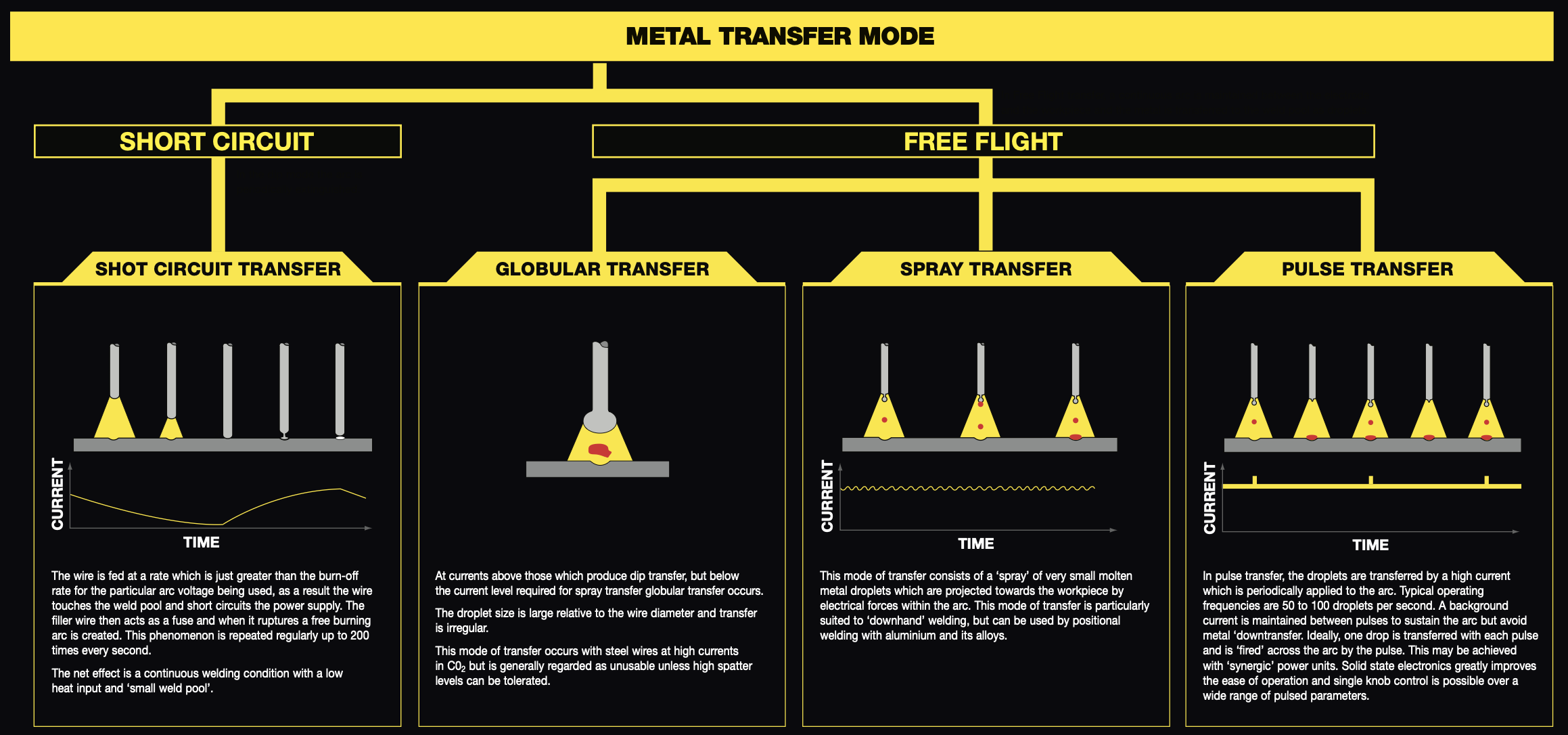

Metal Transfer Modes
MIG welding offers several metal transfer modes, each with distinct characteristics and applications.
  • Short-Circuit (Dip Transfer): The wire tip repeatedly makes contact with the weld pool, extinguishing and reigniting the arc up to 200 times per second. Produces small weld pools and low heat input. Suited to thin materials and positional welding.
  • Globular Transfer: Occurs between dip and spray current ranges. Large droplets transfer irregularly, causing spatter. Acceptable mainly for CO₂ welding.
  • Spray Transfer: Produces fine droplets projected axially across the arc by electromagnetic forces. Provides smooth beads with deep penetration. Best for flat and horizontal positions.
  • Pulsed Transfer: Superimposes high-current pulses on a low background current, detaching single droplets at controlled frequencies (50–100 Hz). Enables spray transfer characteristics at lower average currents, reducing distortion and allowing all-position welding.

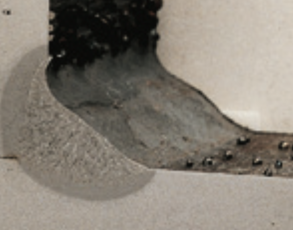

Lack of Fusion Low current, improper torch angle Increase current, adjust inductance, correct torch weave

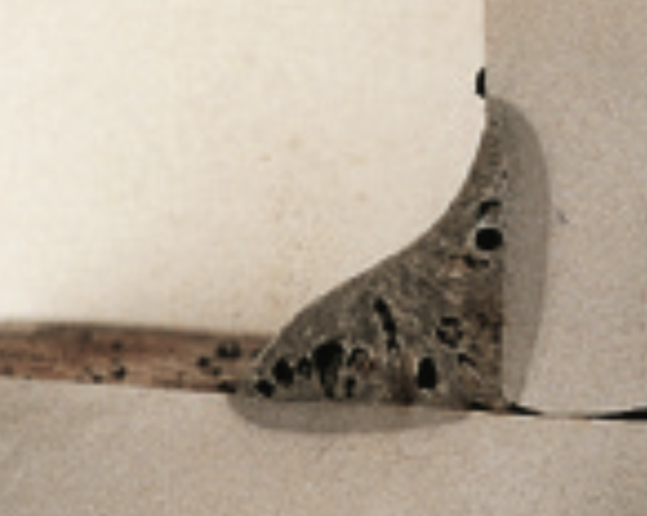

Porosity Surface contamination, hydrogen from moisture Clean workpiece, keep wires dry, use moisture-free hoses

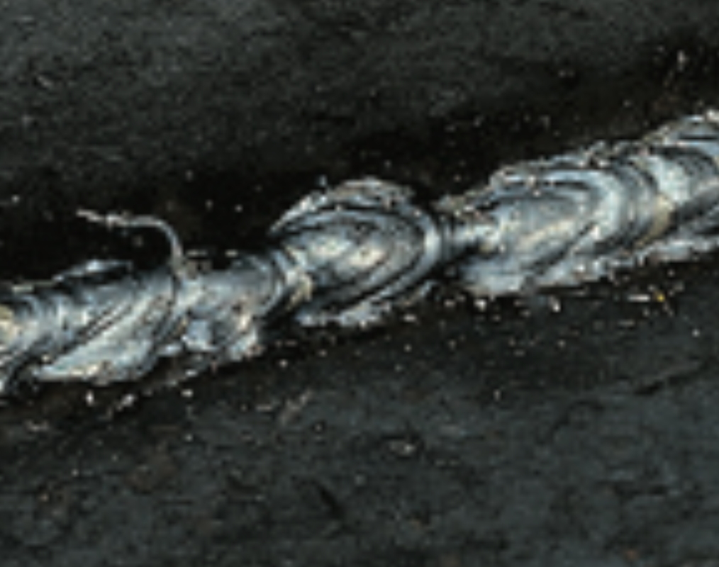

Poor Bead Appearance Low heat input or incorrect technique Adjust parameters, refine manipulationAdvantages of MIG Welding
