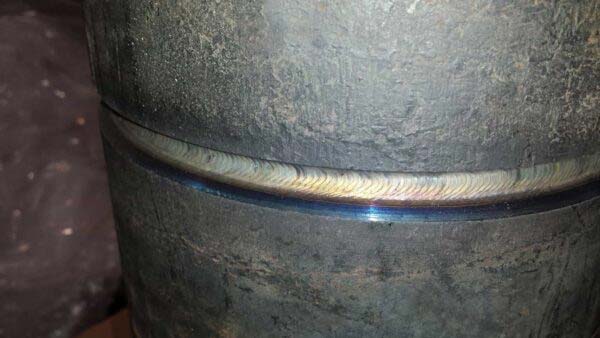

GTAW wire feed pipe welding, in particular, is well-known for its quality and lacks the fusion issues of GMAW.

Tungsten inert gas welding is widely and justifiably known for the quality of the welds it produces. The use of a tungsten electrode to generate and maintain an arc offers the following advantages:
Unfortunately, GTAW wire feed pipe welding also has some disadvantages. It is a difficult process for welders to master, and performing welds to high-specification standards takes considerable training and practice. Automated orbital GTAW removes this disadvantage. It also eliminates welder fatigue as a factor from the process of completing pipe welds and allows the entire diameter of a pipe to be welded in one pass.
