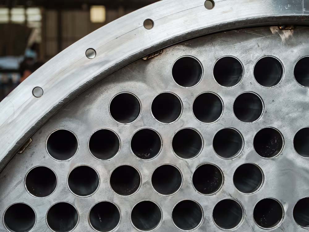

Grade 316 is an austenitic stainless steel composed primarily of chromium, nickel, carbon, and molybdenum. The presence of molybdenum (usually between 2% to 3%) enhances the corrosion resistance of 316 stainless steel and makes it the preferred choice for most industrial applications, second only to 304 stainless steel. Molybdenum is also responsible for improving the mechanical strength of stainless steel. As a result, 316 stainless steel is used in refineries or chemical plants where corrosive environments can present a potential issue, as well as for fabricating jet engine parts or heat exchangers.
