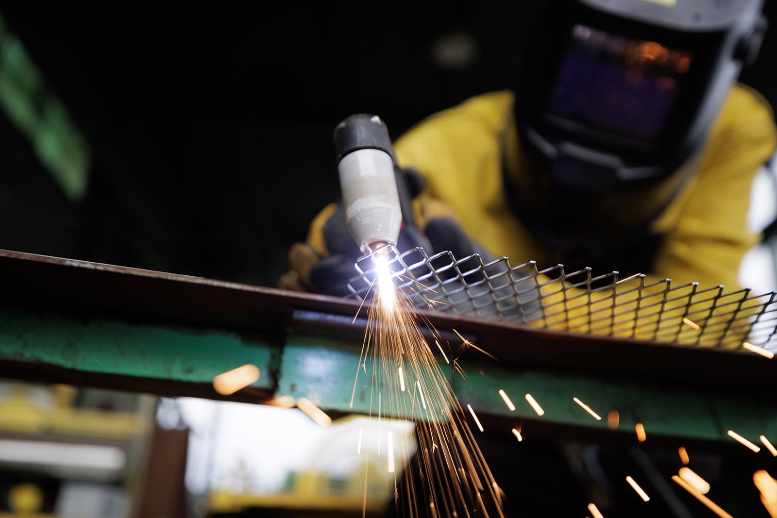

  • Cutting direction — the cleaner side of the cut is always to the right of the direction of travel. When laying out a cut, position the piece so the “good side” faces the direction you need.
  • Grate cutting mode — when cutting expanded metal or grating, switch to grate cutting mode on the Cutmaster 50+ and 70+. This reduces power when the arc is in open air between strands, significantly extending consumable life.
