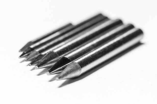

The additives in a tungsten electrode change its properties in ways both subtle and large. Oxides of thorium, cerium, lanthanum, and zirconium introduced to the tungsten lower the electron-work function or the minimum amount of energy needed to move an electron from an atom. This means that less energy is required to start an arc and to maintain it. This has the result of enhancing arc stability while improving weld formation and reducing the level of heat input into the workpiece.
These alloyed GTAW tungsten electrode types create higher quality welds in thin-wall tubing and delicate parts that pure tungsten electrodes would burn through. It also means that they are a better choice for welding metals that are sensitive to heat. The choice of tungsten electrode is especially important when it comes to welding Monel®, Inconel®, and other similarly demanding metals because of the additional level of control that high-quality electrodes offer. GTAW is already widely acknowledged as the best way to weld Monel®, and choosing the right electrode is a key step in assuring a high-quality Monel® weldment. However, the composition of the tungsten electrode used for a weld is not the only factor that matters. The geometry of the electrode tip, whether that tip is pointed or balled, the angle of the tip, the surface finish, and the process used to grind it can all affect the resulting weld.
Typically, tungsten electrodes of all types arrive with blunt tips and it is up to the welder to grind them into the shape needed using a bench grinder. This provides a good enough weld for general manual applications. However, each welder may prepare the tungsten differently utilizing multiple grind methods. The variation and the coarse grind that results from these methods can affect the electrode in the following ways:
Unexpected variations in welds are becoming less acceptable as technical standards and demands for precision and consistency increase. Using machine-ground tungsten electrodes ensures that the electrode is ground to tight tolerances and that the surface is significantly more consistent, eliminating the electrode grind as a source of variation in weld production. This helps welders and welding processes meet increasingly high standards. Eliminating variation is especially important in the case of welding done by automated and orbital welding machines, since these cannot reflexively adjust to variation mid-weld in the same way that an experienced welder can. Utilizing machine-ground tungsten electrodes in combination with automated and orbital welding machines can also significantly reduce downtime. This is due to the combination of precision prepped tungsten and the exceptional arc control provided by the automated GTAW application.
At the same time that demand for precise, high-level welding is increasing, fewer welders are available with the skill and experience needed to make these welds. The solution for many manufacturers has been automating more of the welding process. This is especially true in challenging tube and pipe welding, in which the electrode must be moved around the entire circumference of a circular piece. However, automated orbital welding requires consistency that can only be provided by precision machine-ground electrodes. The developer of any TIG welding program should pay as much attention to the choice of GTAW tungsten electrode type as to welder qualifications and the choice of welding machine. Tungsten electrodes are at the very center of today’s advanced technology, and they will matter even more in the manufacture of tomorrow’s technology.
