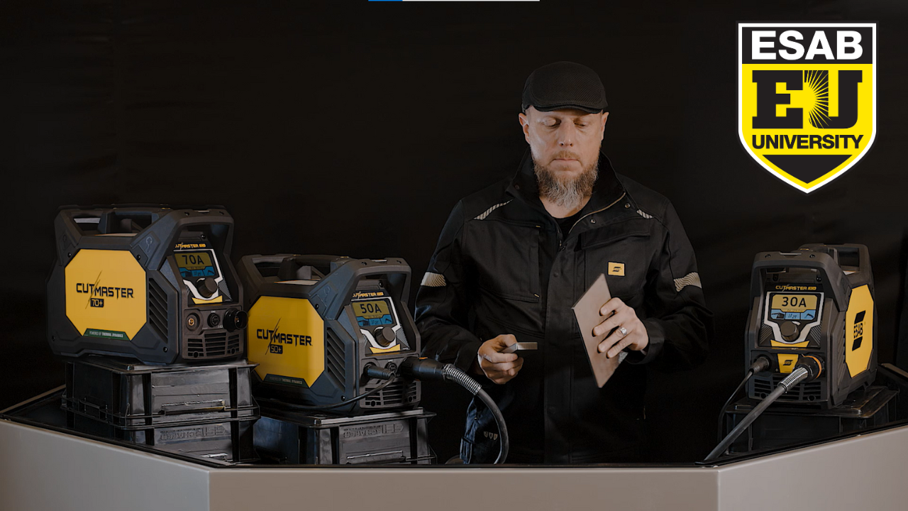

Gouging with the ESAB Cutmaster+ Range
All three Cutmaster+ models support plasma gouging with the appropriate gouging consumables for the SL60 1Torch®. For most gouging applications in a fabrication shop or on site, the Cutmaster 50+ or Cutmaster 70+ are the recommended choice — the higher amperage gives you better control over gouge depth and allows you to work at productive speeds without pushing the machine to its limits.
  • Cutmaster 50+ — 50A, suitable for light to medium gouging on material up to around 20mm
  • Cutmaster 70+ — 70A, recommended for heavier gouging, back gouging on thick plate, and any application where depth and speed of removal matter
Contact your ESAB specialist or distributor to confirm the correct gouging consumable kit for your Cutmaster+ model.
