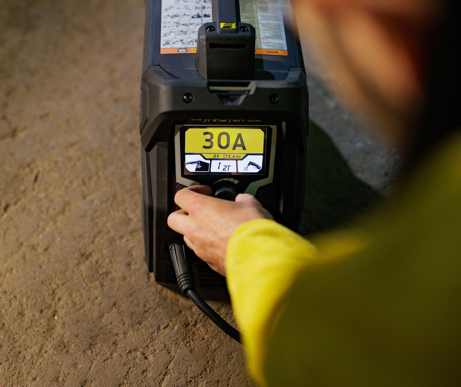

Display and Controls
Older plasma cutters used a simple rotary dial. Modern machines offer significantly more control and feedback, which matters in a professional environment.
Cutmaster 30+ plasma cutter panel.
  • The Cutmaster 30+, 50+ and 70+ all feature a 4.3” TFT LCD display with a glove-friendly adjustment knob — clear to read in bright light or dim workshop conditions, and operable without removing your gloves.
  • The display gives you direct access to amperage setting, cutting mode selection (normal or grate), and 2T/4T trigger mode — all without needing to remove panels or refer to a manual.
  • Fault codes and diagnostic information are also displayed, making it easier to identify issues quickly rather than guessing.
