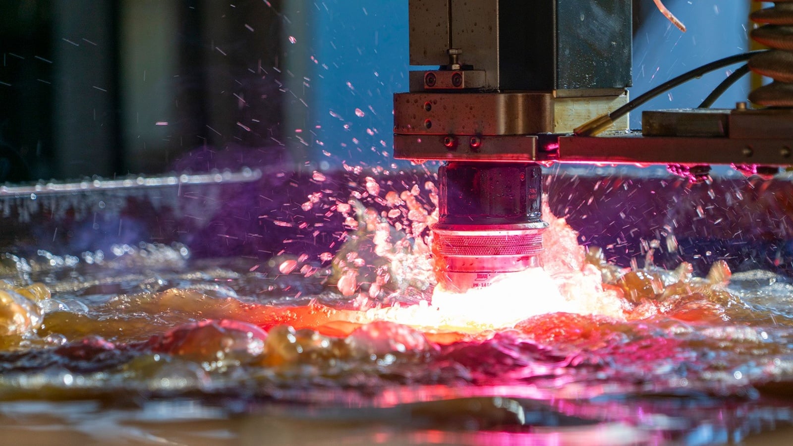

The primary reason for using this type of table is for underwater plasma cutting. Depending on the torch design and vintage, you may be able to submerge the torch and cut successfully without any additional hardware. However, most new Oxygen plasma cutting systems with precision plasma capability will require an air-curtain that clamps onto the torch. The air-curtain uses compressed air to create a bubble around the front end of the torch so that the precision arc is protected from the water. Some plasma torches are not designed for use underwater but may still be used to cut a plate that is sitting above the water.
