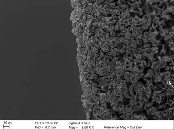

Although there are limited applications for zirconiated tungsten, when it is used it is vitally important that it be of the best possible quality in order to resist contamination from metal vapors. It is equally important that these electrodes have a quality grind and finish. For orbital welding and cladding, zirconiated electrodes should maintain their geometry and integrity throughout an entire shift. The zirconiated tungsten electrodes used in orbital welding must be of the highest quality to perform at an acceptable level.
