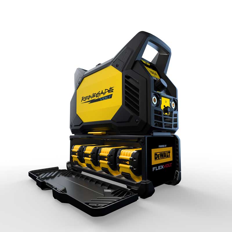

ESAB Renegade VOLT ES 200i powered by four DEWALT® FLEXVOLT® Batteries; also uses 115/230V primary power.
North Bethesda, Md. –ESAB a world leader in fabrication technology, today unveiled its Renegade VOLT™ ES 200i Stick/TIG battery-powered welding system, which ESAB developed in conjunction with Stanley Black & Decker. Powered by four DEWALT® FLEXVOLT® 12 Ah (amp-hour) batteries, Renegade VOLT offers maximum welding output of 150A on battery power. It also connects to 115/230V AC primary power and provides a maximum welding output of 210A on 230V primary. VOLT is an efficient, robust, and portable machine for tough jobs in the field and has the battery power and performance to weld through a standard work shift.
Portable and Powerful
“Renegade VOLT ES 200i revolutionizes the industry as the first-ever interchangeable battery-powered welder,” said Flavio Santos, Vice President & General Manager, Global Equipment Solutions, ESAB Corporation. “Through our collaboration with Stanley Black & Decker, Renegade VOLT offers contractors the benefit of using batteries that work with any other DEWALT FLEXVOLT-compatible hand tools for jobs in difficult-to-reach locations, locations without power, and applications where portability and quick set-up provide operational efficiencies.”
The Renegade VOLT battery box can detach for easier transportation, or when connected to 115/230V power; it also enables users to hot swap the batteries so they can continue welding without interruption. A four-port fast charger (included) charges the batteries from zero to full charge in about 100 minutes. The unit weighs 40 lbs. with the battery box and 25 lbs. when the box is detached. The product will be available for sale in Q3 2024 in Asia market.
“Renegade VOLT offers a more portable and affordable alternative to engine drives for off-the-grid welding,” said Peter Burchfield, Global Director for Light Industrial Products at ESAB. “At 40 lbs., it’s a fraction of the weight and size of an engine drive. Renegade VOLT eliminates many of the costs and hassles of engine drives, including fumes, fuel costs, noise, and the need to drag hundreds of feet of heavy and expensive welding cables or extension cords. With the ability to use 115V or 230V AC primary power to tackle larger projects, Renegade VOLT provides ultimate location flexibility.”
Applications that benefit from Renegade VOLT’s location flexibility include maintenance and repair, construction, shipyard, rail, power generation, offshore, and farm/agriculture.
Best-of-Class
“Renegade VOLT builds on the success of ESAB’s Renegade inverter-based welding platform, which offers best-of-class arc performance to meet the needs of demanding welding professionals,” said Bartosz Kutarba, Global Product Manager, ESAB. Renegade VOLT uses a next-generation current control module with built-in intelligence that can detect and clear a short circuit or manage current transients faster than the microprocessor controls used on other units, minimizing spatter, and creating a stable, more controllable weld pool.
In Stick mode, Renegade VOLT features include adjustable Hot Start, which fine-tunes the optimal energy during the arc starting sequence for improved strike performance and reduced sticking. An Adjustable Arc Force function enables the operator to adjust the arc characteristics so that they are crisper or softer, tailoring the arc for different electrodes, applications, and operator preferences. Preferences can be stored in one of three memory functions.
In TIG mode, Renegade VOLT provides Live-TIG for arc starts without high frequency. Users access all TIG and Stick functions from an easy-to-read color-coded graphical interface.
