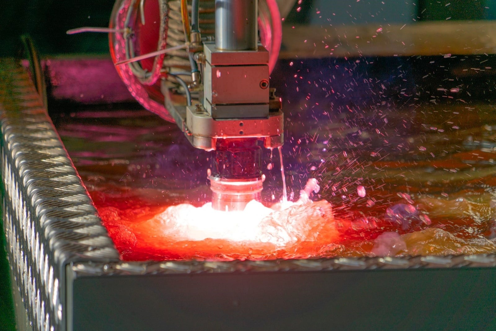

Dry plasma arc cutting of Aluminum plate may require expensive and complicated dust removal systems. It is also a very loud process, producing high-intensity ultra-violet light. Therefore, many companies prefer to cut Aluminum on a water table. Most Aluminum alloys can easily be plasma cut on a water table, Aluminum-Lithium alloys being the exception - see the note below. The majority of alloys can be cut on a water table. Yet the user has to be aware of a very real and dangerous explosion hazard and take steps to avoid it.

The amount of hydrogen produced depends on many factors. But the most significant in this case is the surface area that is exposed to water, and the length of time it is submerged. In the case of a small part cut from aluminum, it may fall into the water for a short period and then be retrieved. It has a relatively small surface area, and therefore generates little hydrogen. However, plasma arc cutting produces a high volume of molten aluminum droplets that fall into the water table. Those droplets, especially the fine particles, have a cumulative surface area. The droplets become very large over time. The droplets can sit on the bottom of a water table for days, weeks, or months. The droplets keep generating hydrogen gas bubbles.
The biggest danger occurs if a plate is left submerged on the table for an extended period. Perhaps an operator loads a plate on the cutting table, raises the water level, and starts cutting a few parts. Then his shift ends, and he turns off the machine and goes home. When he comes in the next day, there could be a significant pocket of hydrogen gas trapped below the plate. If he pierces the plate with the plasma torch and ignites that bubble of hydrogen, a serious explosion can occur. This can result in potential damage to equipment and injure or kill personnel.
