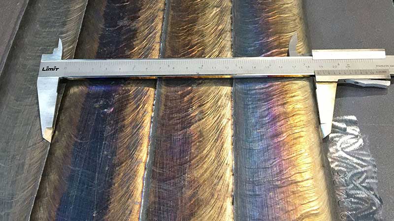

Exaton Ni56 strip electrode
Exaton Ni56 strip electrode for electro-slag cladding has an SFA/AWS A5.14 EQNiCrMo-4 classification. Because of its restricted chemical composition, the weld deposit preserving the metallurgical properties of the strip.
