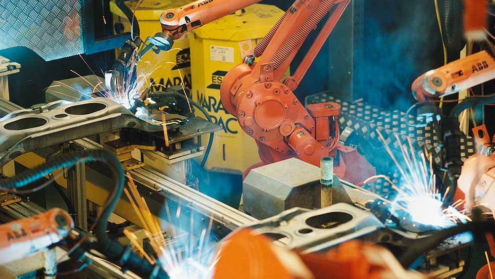

“When developing OK Autrod 2504, we worked with a Tier 1 automotive supplier robotically welding exhaust systems that demanded consistent results,” says Björnstedt. “The customer was very satisfied with OK Autrod 2504’s great feedability and its high mechanical strength.”
