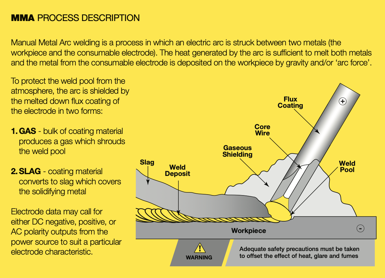

MMA welding works by striking an electric arc between the tip of a coated electrode and the workpiece. The arc melts the electrode core and the edges of the base metal, forming a molten pool. The electrode’s flux coating decomposes under the heat, releasing gases that shield the weld pool and forming a layer of slag on top of the solidifying weld bead.
This two-fold protection prevents contamination from oxygen, nitrogen, and hydrogen in the air — all of which can cause porosity or cracking if uncontrolled. The slag slows down cooling, improving toughness, but it must be chipped and brushed away between passes.

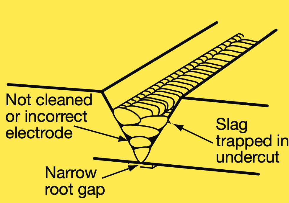

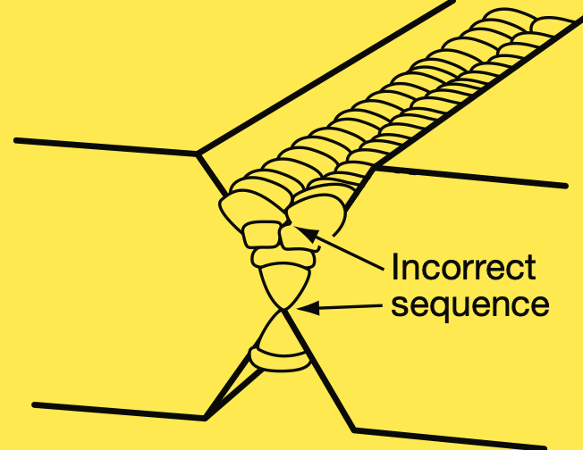

5. Common Defects and Remedies
MMA welding can produce high-quality welds, but incorrect technique or poor preparation may lead to defects. The table below outlines the most common problems, their causes, and remedies:
Defect Example Cause Remedy
Incomplete Penetration Low current, incorrect angle, insufficient root gap Increase current, adjust angle, prepare joint correctly

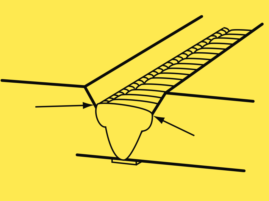

Undercut Excess current, long arc, steep angle Reduce current, shorten arc, hold electrode at 45°–60°

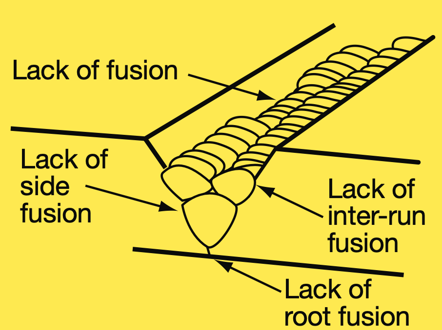

Slag Inclusions Poor inter-pass cleaning, restricted joint, overfill Clean thoroughly, ensure penetration, adjust bead deposition
Lack of Fusion Wrong angle, low current, rust/scale on base metal Correct technique, raise current, clean joint before welding
