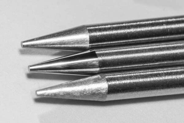

Electrode geometry, including diameter and angle, are important considerations during arc welding preparations. Different angles produce a variety of weld results. While blunt electrodes can handle high amperages and create deeper penetration, sharp electrodes provide a more consistent arc. Using an incorrect electrode angle for the given amperage can reduce electrode life while increasing the likelihood of tungsten inclusion in the weld pool.
Welders can prevent tungsten inclusion by sharpening and polishing the electrode to achieve the desired angle. This can be achieved for tungsten electrodes with the help of bench or angle grinders, belt or disc sharpeners, and chemical sharpeners. The smoothly ground and polished tungsten electrode results in:
However, care is required when sharpening the electrode. Note the following recommendations:
Welders can achieve the smoothest tungsten electrodes by leveraging CNC machining for sharpening and polishing.
Sharpening tungsten electrodes is not a complicated task, but it does require careful consideration. This involves not only electrode preparation and examination but also the welding process. For instance, when performing orbital GTAW, a sharp grind angle is preferable. With the control offered by orbital welding, a sharp electrode can achieve deeper penetration without risking deteriorating the tungsten electrode—even when the amperage is low.
