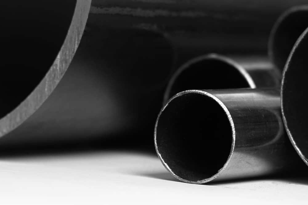

TIG Welding Chromoly Tube: Best Practices
Tubes used in demanding industrial applications must be strong, durable, and corrosion-resistant to operate reliably in high-temperature and high-pressure conditions. The metal for such applications is chromoly, or chromoly steel, a steel alloy composed of chromium, molybdenum, carbon, and iron. The cumulative properties of these alloying elements make chromoly steel ideal for tubing purposes in shipbuilding, power generation, and aerospace engineering.
However, these properties also make welding chromoly challenging. Improper welding parameters and techniques are likely to alter the properties of the metal, leading to brittleness and loss of strength. As such, it is important to note the best practices required when TIG welding chromoly.
