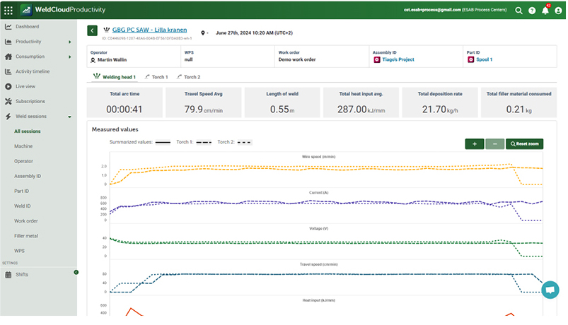

WeldCloud Productivity is designed for operation and production managers to track information generated by the Submerged Arc Welding process: arc-on time, number of weld sessions, wire use, deposition rate and many other metrics. Users can also “tag” or link this information to provide full weld traceability, which can include barcode/QR code scanning of variables such as operator badges, wire lot and Weld Procedure Specification (WPS). The ability to record weld session data directly from a welding power source and immediately compare to a WPS, means errors can be remedied much faster. If a weld is outside the WPS, the system can send an alert so that users can immediately repair the weld and begin identifying the root cause of the problem(s). This can be monitored on multi-torch applications and provide a combined heat input total or individual torch heat inputs per customer needs.
Instead of the tedious process of manually recording welding data, which is also subject to human error and tampering, the process is digitized for speed and accuracy. With a WeldCloud-enabled power source, welding data can be recorded, analyzed and linked to the WPS, providing users and their customers greater quality and confidence in real-time.
The system has the ability to connect ERP and other systems to WeldCloud using its API (Application Programming Interface). By enabling digital communication with a central, online platform, it connects the shop floor and management with real-time data. It also allows inspectors and QC departments to instantly track and monitor production status, weld-by-weld. The weld inspectors can enter notes directly from the field, short-cutting the communication between project management, operators, inspectors and sub-contractors. The software sends all the information on each weld directly to the cloud, which can then be accessed via a computer, tablet or other mobile device. Because the information is transmitted directly from the shop floor, there is no chance for misinformation.
