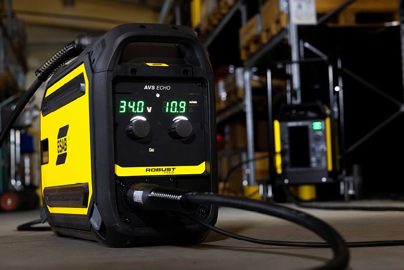

RobustFeed AVS ECHO
The RobustFeed AVS ECHO voltage-sensing wire feeder enables both voltage and wire feed speed adjustment at the feeder.
Durable, High-performance Feeder
RobustFeed, which won the prestigious Red Dot Award for product design, improves durability, ergonomics and performance in harsh industrial applications. RobustFeed AVS ECHO has an IP54 weatherproof protection rating. It features a completely-sealed wire feed compartment that protects the wire and internal components from water splashes in all directions. The seal also keeps out dirt, grinding dust and other particles than can damage feeder components or degrade the wire and contaminate the weld pool. The controls, as well as the power and gas cable connections, are also protected inside the housing. On the outside, the feeder uses a double-wall design that has special zones to provide abrasion and impact resistance, while a reliable strain relief removes cable stress.
“RobustFeed AVS ECHO is the only feeder in its category that is truly weatherproof. You can leave this feeder in the rain or drag it through the dirt and it will continue to perform reliably,” says Toma. “Coupled with ECHO technology, its ultra-reliable performance delivers maximum uptime.”
Operator Friendly
When carried by the middle handle, RobustFeed AVS ECHO rests comfortably against the side of the operator’s body when walking longer distances. The feeder has three crane-certified handles and two additional lifting points for best-in-class portability and maneuverability. Its front and rear handles make it easy to carry up a ladder, maneuver through confined spaces or pass the unit from one person to another. For greater mobility, the RobustFeed AVS ECHO has an optional wheel kit that mounts on either the bottom or side of the feeder, and the HMI can be rotated 90 degrees to keep the display upright in both configurations.
The RobustFeed AVS ECHO accepts 8- and 12-in. diameter wire spools, measures 23.4 x 9.8 x 16.9 in. and weighs 40.5 lbs. It feeds solid wires as large as 5/64 in., cored wires up to 3/32 in. and has a wire feed speed range of 51 to 985 inches per minute. It can handle a maximum output of 500 amps and a duty cycle rating of 100% at 350 amps, the best in its class. Where other portable feeders only have 2-wheel drive, the RobustFeed AVS ECHO uses a 4-wheel drive mechanism and encoder-controlled feeding for precision feeding.
