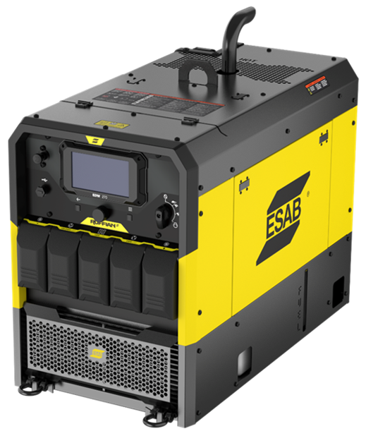

North Bethesda, Md. – ESAB has introduced the Ruffian™ EMP 270G engine-driven welding generator, which offers a multiprocess welding output of 270A at 100% duty cycle and 11kW of generator power through its multiple 120VAC and 240VAC auxiliary outlets. Assembled in Texas, the Ruffian EMP 270G combines ESAB’s next-generation inverter with the proven reliability of a made-in-America 23.5-HP KOHLER® Command Pro CH730 gasoline engine. The machine is built and tested for harsh construction environments, designed with a small footprint for service trucks, and features smooth performance in all welding processes.

Weighing only 425 lbs. with base mounting bolt holes and an 11-gallon fuel tank for hours of run time, the Ruffian EMP 270G is lighter and has a smaller footprint than other machines in its class. Its modern and rugged exterior is tested in the harshest environments to meet the highest global standards and is backed by a three-year warranty. Designed with fully removeable doors, it allows easy access to the battery and other internal parts and means changing the oil requires no tools and little time.
The Ruffian EMP 270G has four 120VAC 20A GFCI receptacles, one 240VAC (6-50R) dedicated outlet and another 120/240V hybrid outlet, all protected by circuit breakers and rubber covers. This auxiliary output can run grinders, drills, saws, lights, radio, air compressors, pressure washers, pumps, refrigerators, furnace blowers, microwaves, and light motors. It has a peak (or surge) output of 11kW for stronger starting performance and continuous output of 10.5kW. Contractors can use the generator power to create a two-work station, either arc welding or even plasma cutting, such as by running a Rogue ES 201iP PRO Stick/TIG welder or a Thermal Dynamics® Cutmaster® 30+.

Ruffian EMP 270G
Assembled in Texas, the Ruffian EMP 270G offers a multiprocess welding output of 270 amps at 100% duty cycle and 11 kW of generator power.
