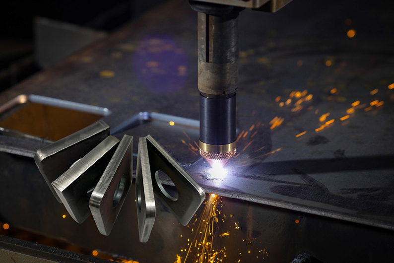

“These new 110A PLUS and 70A PLUS consumables significantly improve automated cutting performance compared to other consumables,” says Dirk Ott, VP – Global Plasma Automation, Thermal Dynamics. “The advantages of the 110A PLUS consumables – two times longer parts life, 30% more piercing capacity on ¾-in. steel and 10% faster cutting speeds – come from leveraging our experience with high-precision technology and gas flow control.”
110A PLUS Consumables
The new 110A PLUS consumables from Thermal Dynamics deliver two times longer parts life, 30% more piercing capacity on ¾-in. steel and 10% faster cutting speeds for the Cutmaster A120 plasma cutter.
The advanced 110A PLUS and 70A PLUS consumables include electrode, gas distributor, tip, shield cap and other torch components. At 110A, users can cut thicker plate while boosting productivity with cutting speeds of 100 ipm on ¼ in. steel, 70 ipm on ½ in. steel and 37.5 ipm on ¾ in. steel (an average of 10% faster). Achieving outstanding cut quality over a wide range of thicknesses also reduces the need for secondary operations, increasing productivity.
