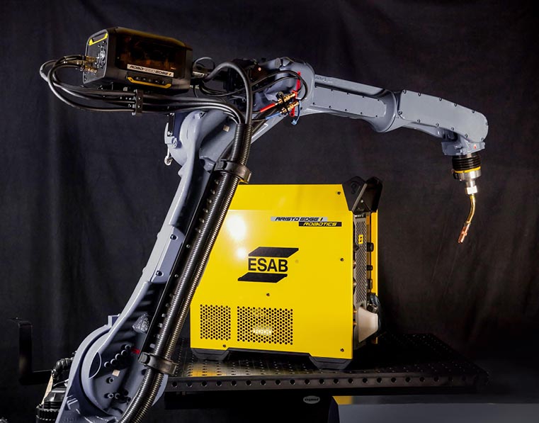

North Bethesda, Md. – The ESAB RoboSystem automated GMAW welding package features the next-generation Aristo® Edge 500R power source and RoboFeed Edge robotic wire feeder. It also features the ESAB Connect browser-based user interface, an automation gateway with support for the seven most common communication protocols, a variety of torch options and simplified cable dressing kits for leading robotic arms. The components use high speed, low latency communications to support fast, effective process control and coordination between connected devices.
An innovative mounting design enables fast installation of the RoboFeed Edge feeder on hollow wrist and standard arm robots, and features such as programmable buttons on the torch allow for easy adjustments, such as for setting a specific wire stick-out. The user interface is easy to navigate and understand, and the service mode can be activated from the feeder to simplify routine maintenance. The ESAB RoboSystem also features built-in connectivity for InduSuite applications such as WeldCloud Fleet, WeldCloud Productivity and WeldCloud Assembly.

ESAB Robo System
The ESAB RoboSystem streamlines implementation for automation integrators and end-users and features GMAW WeldModes that provide high-quality welds with minimal adjustments needed.
