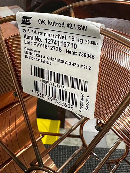

North Bethesda, Md. – To improve performance in robotic MIG welding applications, ESAB has launched OK Autrod 42 LSW, a copper coated ER70S-9 solid wire with a chemistry engineered to create minimal slag and silica islands on the weld bead. Available in diameters from 0.035 and 0.045 in., OK Autrod 42 LSW will be showcased in 12-in. spools and a Marathon Pac™ bulk wire system in booth W3801 at FABTECH, October 15 – 17, in Orlando, Florida.
“We enhanced the metallurgy of OK Autrod 42 LSW so that slag self-releases or easily brushes off,” says Kaar Valluvan, Director of Product Marketing at ESAB. “Where most slag islands are silicon oxides, the few slag islands produced by OK Autrod 42 LSW are manganese and titanium oxides, which makes clean-up easier before the weldment moves to galvanizing or painting.”
OK Autrod 42 LSW
ESAB’s new OK Autrod 42 LSW is a copper coated ER70S-9 solid wire engineered to minimize slag and silica islands on the weld bead to reduce cleaning and the total cost of welding.
OK Autrod 42 LSW provides good wetting action so the weld puddle flows readily to create a smooth transition at the weld toe, a better bead profile and better surface appearance. Spatter generation is minimal. OK Autrod 42 LSW has a minimum tensile strength of 71 KSI and typical impact values of 93 ft.-lbs. -22 oF.
