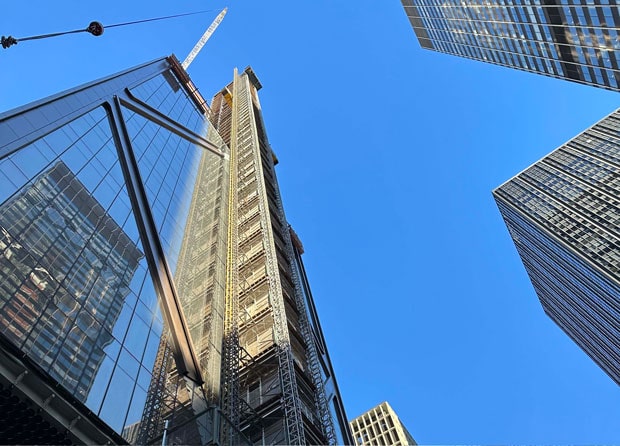

North Bethesda, Md – The New York City skyline is defined by iconic skyscrapers that result from the collaboration between world-class companies. Two collaborators celebrating today’s “topping off” ceremony of the new JPMorgan Chase headquarters at 270 Park Avenue include NYC Constructors, a subsidiary of DBM Global Inc. and a leading steel erector for world-class high-rise construction, and ESAB (NYSE: ESAB), a leading global provider of welding filler metals and welding and cutting equipment. Executives at the topping off ceremony signed the final steel beam before it was hoisted into place on top of the 1,388-ft., 60-story tall building.
“We are proud to have partnered with ESAB to successfully complete another high-rise in New York City,” says Barry King, President of NYC Constructors, “At just under 94,000 tons of structural steel, 270 Park Avenue required 170,000 pounds of field welds, a staggering amount we could not have achieved without the support of ESAB. We look forward to a continued partnership with ESAB on future projects.”

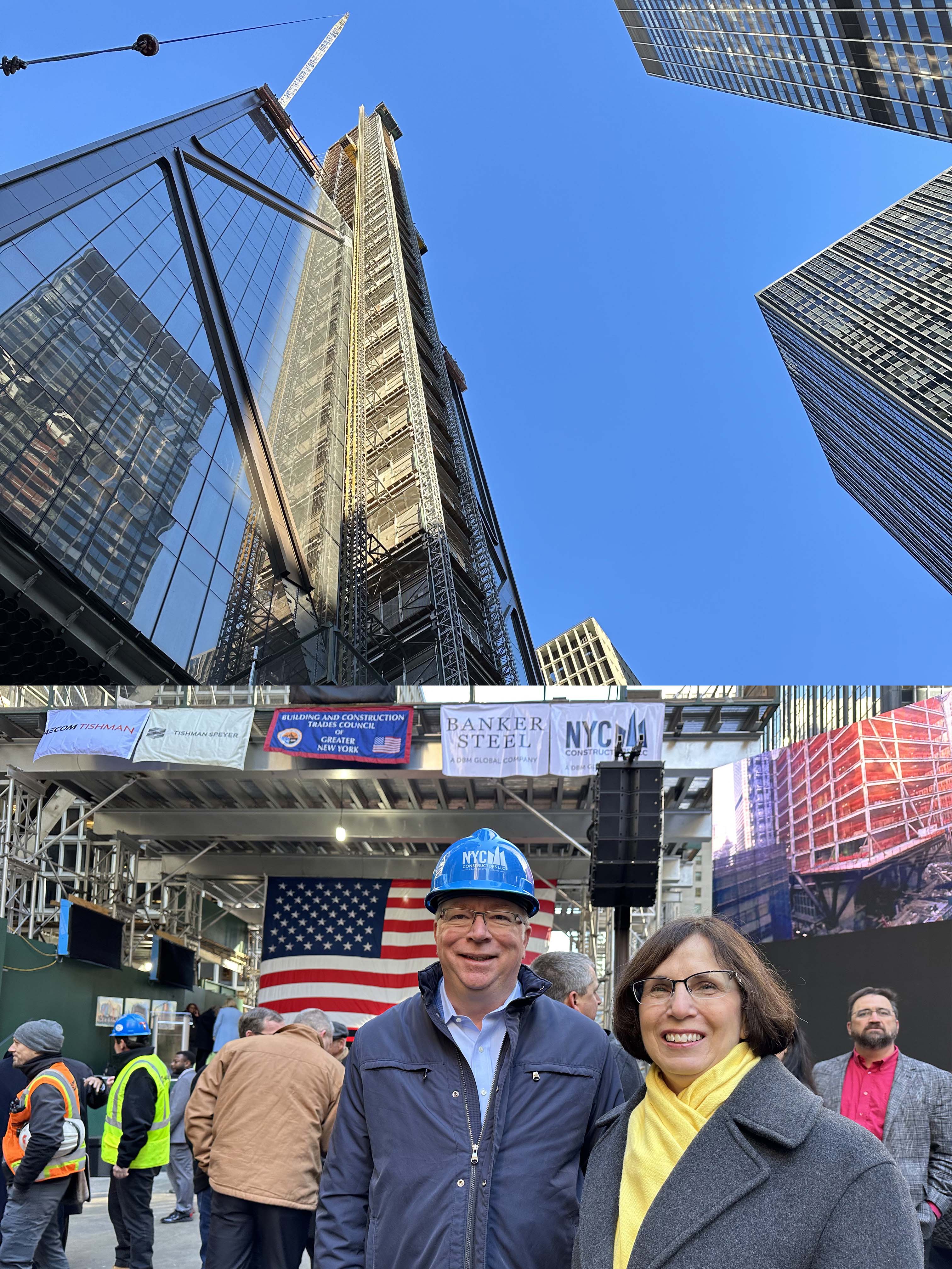

Topping off a great collaboration, Barry King, President of NYC Constructors, and Eleanor Lukens, ESAB President of the Americas, celebrate during the topping off ceremony for 270 Park Avenue, a 1,388-ft.-tall building that is the new headquarters for JPMorgan Chase.
