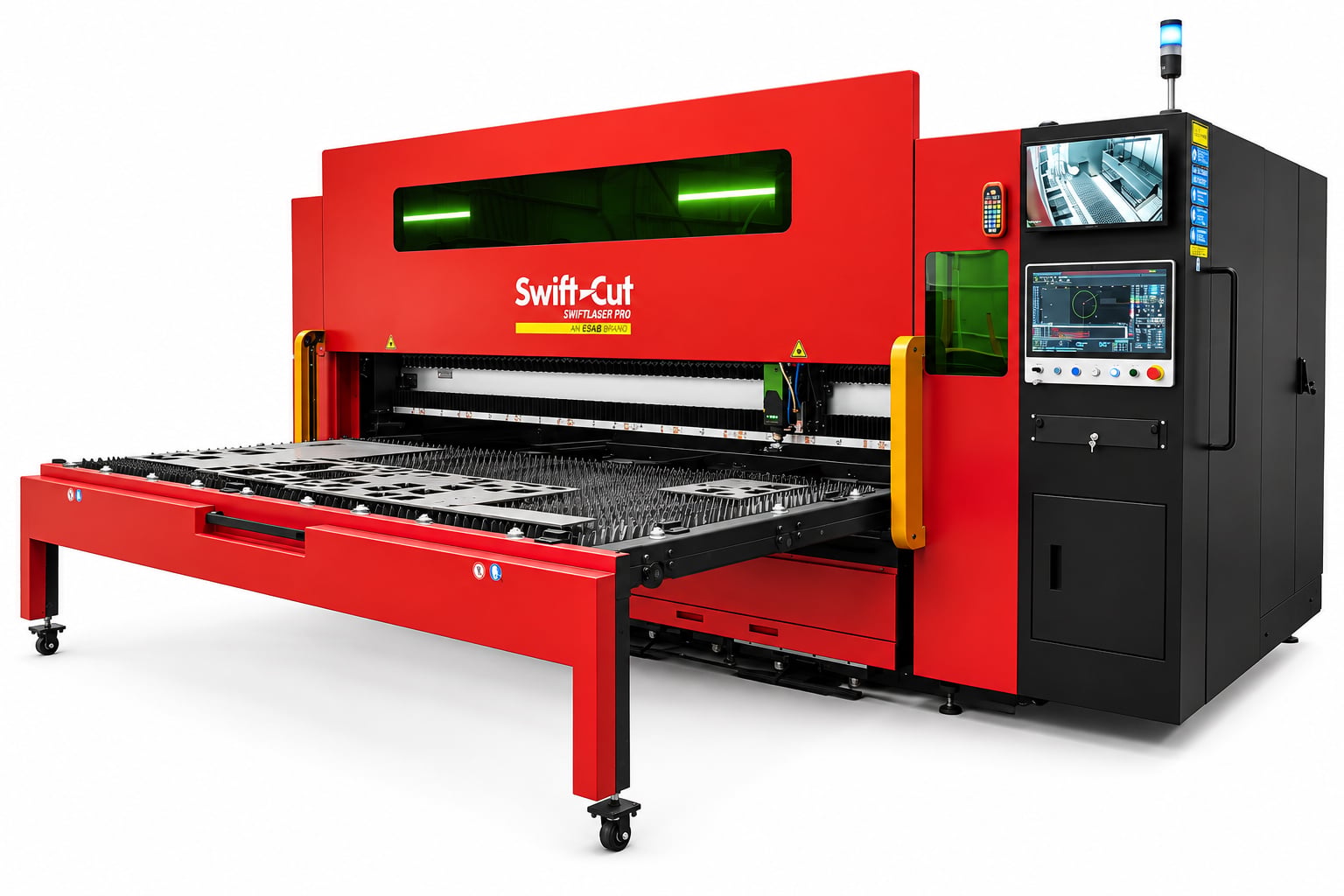

Swift-Cut Swift-Laser Pro
The new Swift-Laser Pro fully enclosed CNC fiber laser cutting system combines high-speed, precision cutting with intuitive operation and established Swift-Cut application and technical support. It is initially available with a 5 x 10-ft. cutting area and 3-kW and 6-kW power options.
