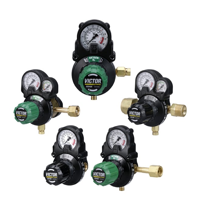

North Bethesda, Md. – Victor, an ESAB brand, today unveiled five new EDGE 2.0 Series regulators to cover two-stage, line, station, manifold and high-capacity applications. EDGE 2.0 Series regulators are available for all common gases, including industrial air, oxygen, argon and other inert gases, CO2, N2O, hydrogen, methane, acetylene and alternate fuels such as natural gas and LP gas. All EDGE 2.0 Series regulators include the patented SLAM™ (Shock Limitation and Absorption Mechanism) safety technology, a long-life stainless-steel diaphragm and large, high-contrast gauge faces that enable operators to more easily see and set pressure.
Victor EDGE 2.0 Series
Victor EDGE 2.0 Series regulators are now available for two-stage, line, station, manifold and high-capacity applications.
The new Victor EDGE 2.0 Series includes the following models:
•    ETS42 heavy-duty, high-capacity two-stage cylinder regulators with built-in rear mounting option for enhanced flexibility when mounting in panels or other OEM-type equipment (replaces the VTS700, ETS4, and VTS450 families).
•    EST42 high-capacity, single-stage regulators for gas distribution and pipeline systems (replaces the EST4 family).
•    ESL42 high-capacity, single-stage regulators for gas distribution and pipeline systems (replaces the ESL4 family).
•    ELC42 single-stage, liquid cylinder regulators for inert gas, oxygen and CO2 (replaces the ELC4 family).
•    ESS72 heavy-duty, high-capacity, single-stage cylinder regulators (replaces SR700, ESS7 and others). A built-in rear mounting option uses 5/16-24 screws instead of a large coaxial nut, providing a more secure mounting that isn’t susceptible to rotation like traditional panel mount regulators.
