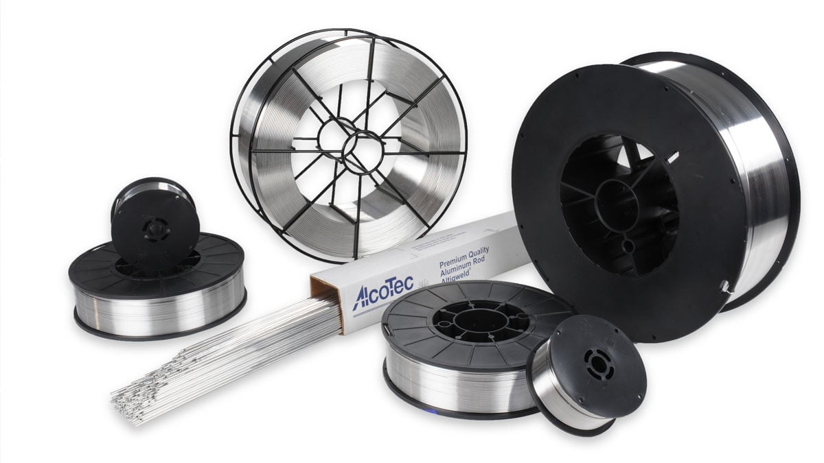

The quality and cleanliness of the aluminum welding wire can be a major factor. If the welding wire is of inferior quality it may be virtually impossible to produce acceptable porosity levels.To achieve low porosity levels for x-ray quality welds, it is also important to understand the methods available for the effective removal of hydrocarbons and moisture from the weld area, and to incorporate the appropriate methods into the welding procedure. If these contaminants are present in the weld area during welding, they will produce hydrogen and greatly contribute to porosity problems.

Correct cleaning of the aluminum parts prior to welding, use of proven procedures, well maintained equipment, high quality shielding gas, and a high quality aluminum welding wire that is free from contamination, all become very important variables if low porosity levels are desirable. Porosity is typically detected by radiographic testing of completed welds. However, there are other methods that can be used to evaluate porosity which do not use radiographic equipment. The nick-break test for groove welds (fig 2 and 3) and the fracture break test for fillet welds can be extremely useful on test plates when evaluating a new cleaning method, during preliminary procedure development and for day to day weld quality verification.
