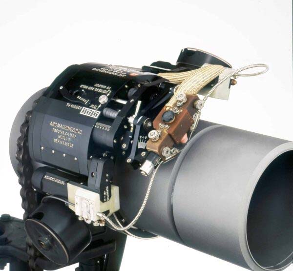

In orbital welding, the operator mounts the weld head by clamping it to the pipe directly (like a set of vice grips) or by using a guide ring fitted to the pipe. With both methods, the weld head moves around a typically stationary pipe. The operator monitors the weld in case an intervention is needed. Orbital welding offers the following advantages compared to traditional manual pipe welding:
