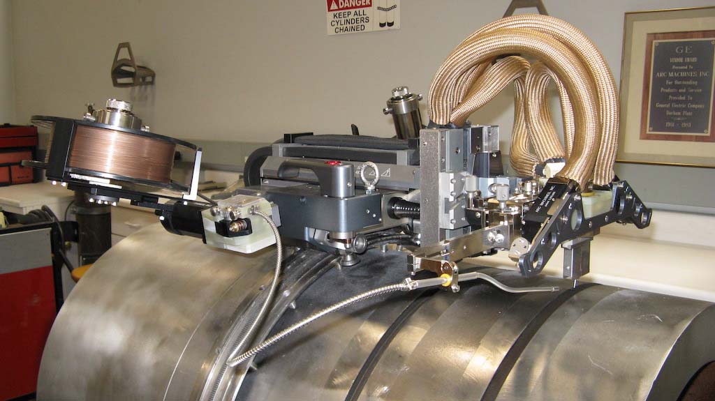

All three arc welding methods have been adapted to orbital welding. When it comes to MIG vs TIG vs Flux Core, they all have different advantages and disadvantages. They find their best use in different parts of orbital welding, and all three may be combined to complete a single orbital weld in big-bore pipe welding and other large-diameter pipe welding.

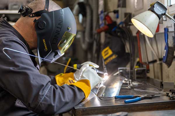

If the only consideration was the strength and quality of the weld bead resulting from welding, then TIG would win every time. However, quality is not the only consideration. TIG welding is difficult to master. The problems in producing welds that lived up to the full potential of the TIG process is what led to the invention of orbital welding in the first place. Only by automating the process could the full potential of TIG be realized repeatedly and reliably.
However, even with the reliability that comes from orbital welding, the process is still very slow. Filling in a thick pipe sidewall using only narrow gap welding is time consuming; on the order of several hours, at least. The process is also not very portable and is sensitive to changes in the air. Wind can blow away the shielding gas and ruin a TIG weld. If you need to weld a pipe to a fixed installation in an outdoor environment, then a tent might need to be erected.

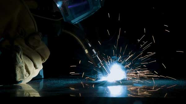

MIG is a gas shielded process, and it requires a lot less amperage to strike an arc and maintain it. This produces purer welds compared to FCAW. It also translates to less heat and a reduced arc welding heat-affected zone. The process performs better on thin-walled materials and metal like stainless steel that can distort with too much heat; reduced heat though can result in a lack of penetration. Poor sidewall fusion has also been an issue when MIG welding has been adapted to orbital.

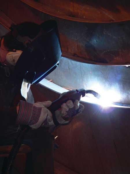

Flux core is a wire feed welding process like MIG. However, it depends on a core of flux in filler wire to create a pure metal weld. When the arc is struck, the flux melts along with the metal, bonds with any impurities and floats to the surface of the weld where it protects the weld from further intrusion. This results in a structurally strong weld, but one that is more mixed than either TIG or MIG welds.
Properly performed MIG welds are objectively of metallurgically higher quality than equivalent FCAW due to the gas shielding. However, it is an extraordinarily fast welding process, incredibly portable, and can produce acceptable welds in poor environments. If one was forced to weld in the midst of a hurricane, Flux core would be the process to use if options were provided.
