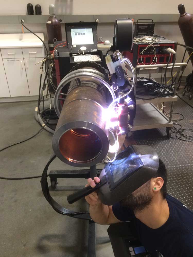

The solution for many of the most demanding industries is to automate the process of welding tubes and pipes—a process known as orbital welding. An orbital TIG welding system automates the most difficult aspects of the welding process, allowing the operator to focus on delivering quality results.
Orbital welding is an arc welding technique in which a welding electrode is rotated around a workpiece that remains fixed. In other words, the weld head “orbits” the workpiece. The history and uses of orbital welding have been extensive, including most arc processes except shielded metal arc welding, also known as SMAW or stick welding. The constantly shrinking nature of the consumable electrode, as welding progresses, makes automating SMAW welding prohibitively difficult. However, automated or semi-automated orbital welding systems can be found for flux core arc welding (FCAW), gas metal arc welding (GMAW), as well as gas tungsten arc welding (GTAW). GTAW, or TIG, is actually the original orbital welding system that was designed in the 1940s to meet the demands of NASA’s X-plane program.
These orbital TIG welding systems are a multicomponent system that is designed to weld either the interior or exterior circumference of a pipe or tube using a tungsten electrode in a specially adapted weld head. The process is used for autogenous tube welding, tube to tube sheet welding, and even big bore pipe welding. Although large diameter pipe welding often involves additional welding processes. Orbital TIG welding is a slow process, and the larger the diameter of the pipe, the longer it can take. Hot wire GTAW can speed up deposition rates. Another option is to use an orbital TIG welding system to complete the most critical root pass and complete cap passes with another process like GMAW or FCAW. These additional welding processes can significantly speed up the production of large diameter pipe welding or fabrication of other similarly large diameter or thick-walled materials like welding pressure vessels.

As sophisticated and diverse as orbital weld heads are, they are actually the simplest part of an orbital TIG welding system. Modern power supplies are substantially more than just a transformer that puts high voltage power through to the weld head. They are sophisticated programmable control units that control not only the weld head but also gas, electrical current, and everything else that goes to the weld head.
A typical arc welding power supply is not a simple system. At the very least, it converts the electrical current coming into the polarity or current type that is needed to complete the weld. In wire feed arc welding processes like GMAW and FCAW, it includes the mechanical systems necessary to feed the wires. In processes like GMAW and GTAW, where gas shielding is used, a power supply also includes gas feeds and may include ways of digitally adjusting the gas flow rate.
Orbital welding power supplies must manage all of the above, plus make allowances for programming that will guide the weld heads through their welding procedures—likely to include multi-dimensional movement, changing heat controls, and wire speed feed through different parts of the weld’s orbit. Higher heat is needed to ensure fusion at the weld’s start, and faster wire speeds are potentially needed while the weld head moves through the overhead position. The power supply of an orbital TIG welding system is effectively a welding robot’s brain but requires even more adaptability in both software and hardware.
