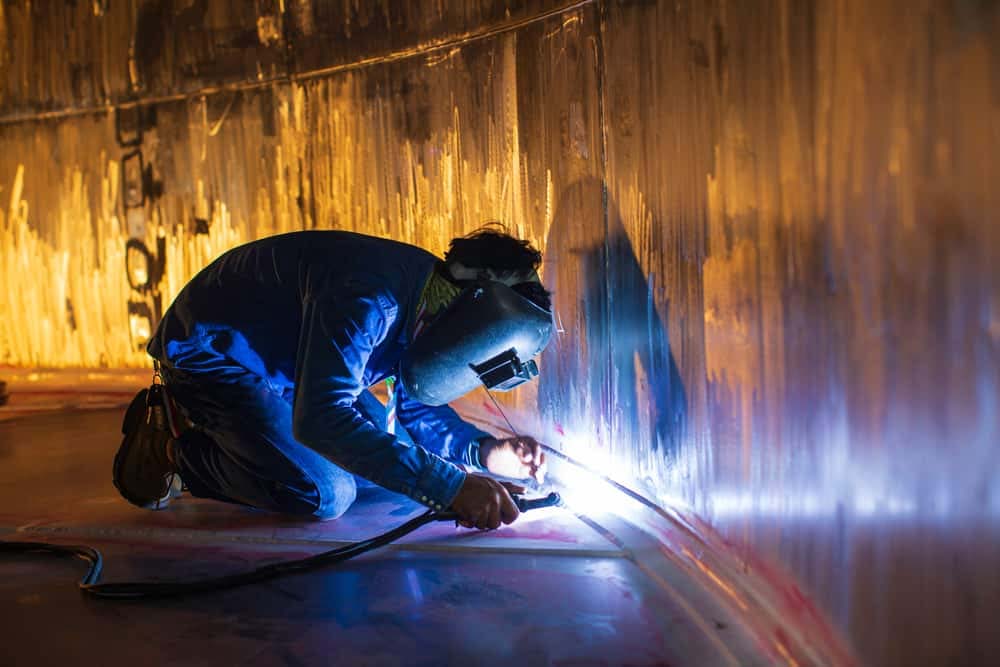

Despite wearing a welding mask, one of the most reported issues amongst welders in vessels and tanks is flash burn to the eyes. The culprit is the light from the arc being reflected by the tank’s interior surface, especially if the tank is built from a reflective metal like stainless steel. The secondary reflection of the light off the interior of the lens of the welder’s mask into the eye is sufficient to burn the eye. Broadly the risks of welding in confined spaces fall under the following categories:
For the most part, avoiding the worst hazards of welding in confined spaces is a matter of common sense. Confinement hazards can often be addressed by disassembly or removal of equipment that isn’t likely in use while welding is underway. For example, suppose it isn’t possible to remove parts of the confining structure. In that case, the careful placement of welding equipment and leads can help minimize the risks of the welder becoming unnecessarily encumbered or trapped.
Radiation hazards like burns due to light and heat can be avoided by providing proper personal protective equipment (PPE). A simple hood blocks light from the rear entering a welders mask. Proper cleaning of a confined space before welding and monitoring during welding can reduce the risk of fire and explosions.
