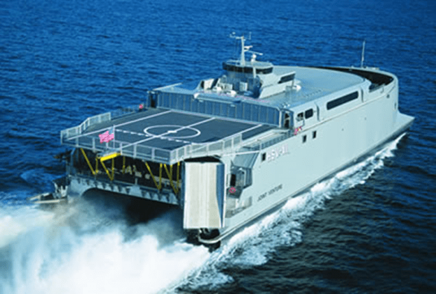

The US government has awarded Bollinger / Incat USA, the charter for a High-Speed Craft (HSC) for a multi-service program operated by various arms of the US military. The HSC Vessel, now known as Joint Venture HSV-X1 (see fig 1) is being used for evaluation and demonstration trials in order to assess the usefulness of such technology in US military and Coast Guard applications. The Joint Venture was selected as the optimum vessel to deliver the best performance for the scope of work required by the military.
The scope of work listed the minimum essential capabilities necessary to meet military operational needs. Undergoing a major refit with innovative design and construction, the craft was upgraded and fitted with military enhancements such as a helicopter deck, stern quarter ramp, rigid hulled inflatable boat, deployment gantry crane, and troop facilities for 363 persons, crew accommodation, storage facilities, medical facilities and long-range fuel tanks. As the Joint Venture continues to excel in her experimental role, Incat’s intention to see the military potential of such craft realized took another step forward in September 2002 with the sale of USAV TSV-1X Spearhead to Bollinger/Incat USA for charter to the US Army.

Fig 1 The Joint Venture being used by the US Military for evaluation and demonstration trials.
